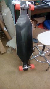

After gaining some confidence from a working first prototype (see Mark I) I am making some major upgrades. Inspired by the erganomic design, but daunted by the price of the Boosted boards, I have decided to explore the full potential of the electric longboard.

  • For now I will use the chassis from the Mark I board.
