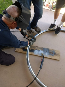

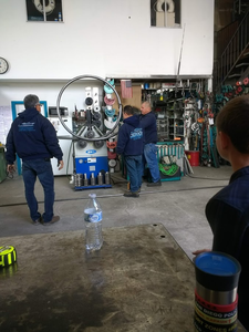

Step 1: Bend Metal Tubing for Main Wheel and Upper Frame
First you want to bend the main wheel and inner frame piece. This will probably be the biggest limiting factor for most people. Not many fabrication shops have a bender that big. If you can through this step, you’re well on your way. We made ours about 4 1/2' OD. Rule of thumb in determining diameter: the smallest the main wheel can be, while maintaining proper driver comfort.
As a note, just realize when you're sizing the wheel to yourself, it's not necessarily the main wheel you want to size. You want to measure your fit in the monowheel to the ID of the inner curved piece that runs around the inside of the wheel and houses the upper roller. If you size your fit to the main wheel, when you build it, you will find that the head space inside will have shrunk.
