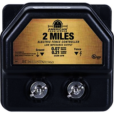

So, I decided to electrify the perch using a set-up designed for fencing in large areas (a two-mile perimeter in the case of the least expensive fence charger I could find. The charger itself was intended and designed to be used inside, plugged into a standard US electrical outlet. I needed to install it closer to the nest box, thus out of doors. This required a weatherproof enclosure and the project was on.
  • Electric Fence Controller - Tractor Supply Store

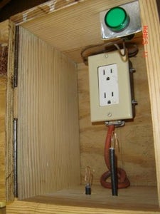

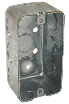

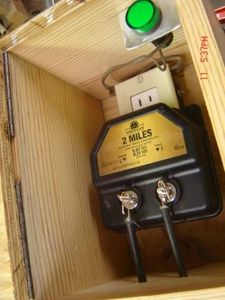

Once the four sides were sorted, a bit of glue and some 18GA finish nails served to hold 'em together while I attached the back (pilot holes and wood screws) and played around with the electrical outlet box while the Fence Charge was plugged into it to refine the placement to accommodate the various wiring to the box, to the 'fence,' ground rod and finally to the indicator light that needs to be protected from the weather and visible from outside the box that protects it.

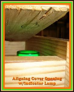

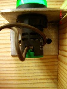

So, I needed to figure out how to mount that indicator lamp. The one I had was designed to mount in a (thin) panel.

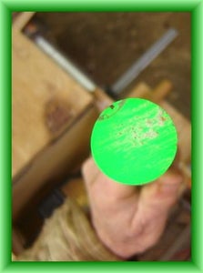

I had a section of round plastic rod I knew it would transmit light and could be cut and polished easily. So, the idea was to cut a hole in the door just large enough to fit a piece of the tube in in far enough from the edges of the door to allow for drilling such a large hole.
This demanded mounting the door - rather than trust measurements in three dimensions - and mounting the indicator light.
Step 2: Indicator Light Bracket
My indicator lamp was designed to mount in a (thin) panel.

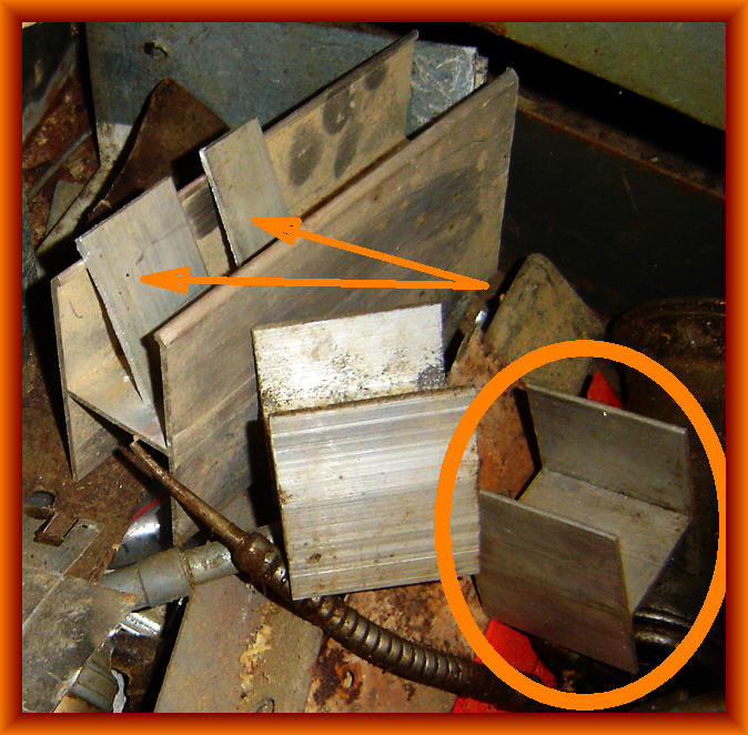

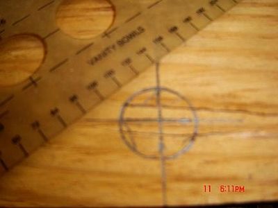

I decided I needed a right-angled bracket sufficiently large enough to allow drilling a large hole for mounting the light ("Mounting hole size: 22mm/0.87in") and room for a couple of screws on the other leg to mount the thing (assembly) to the box and went to my small metal scraps drawer and found some pieces of vinyl railing reinforcement we used on the porch of a Habitat build (the railings come in fixed lengths and we cut the plastic railing and the reinforcement to fit. Naturally, I found the shiny metal scraps worth carting home.)
The reinforcement was shaped like an I-beam. All I had to do was cut away the bits that were not a bracket. But, first, I drilled a pilot hole in the center while I had the most material to work with as the material was relatively thin and the drill bits might 'catch.' distorting the material if it was not held securely. I have a set of five (inexpensive) step drills (from two HFT sales back when you got a freebie with every sale - anyone need a flashlight?) and wound up getting close, test fitting, drilling a bit more, repeat until I had the perfect opening for a nice fit.
Then I cut away all the bits that weren't the mounting bracket, drilled to holes for mounting screws and cleaned up/smoothed out the edges with a file and sand paper.

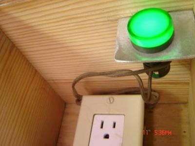

I played around with possible locations until hitting on one I thought perfect. As it turns out, it wasn't, but it serves!
Now to a hole in the door.

The section of plywood I'd cut was a quarter-inch or so long and over hung the (jamb?) side of the opening essentially forming a lip "that could serve as a handle of sorts," I thought. Then, running with that idea I cut up a scrap piece of walnut - rabbiting out the depth of the overhang the thickness of the plywood and gluing it in place to create a three quarter inch wide 'handle' a man riding by on a fast horse might mistake for intentional.

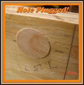

Once the door was fastened, I could close it over the indicator light and mark the inside face of the door so I might drill a hole to hold a section of the plastic rod to serve as a lens. I removed the door, took it to the drill press nailed the hole position only to realize the 'bad side' of the plywood was facing out - not in.
I had to remove the door, flip it 180, mount it again, mark it again, drill it again, fit it again and then turn a dowel out of a scrap to fill in the first hole, toothpicks and fine sawdust to fill-in the 'old' screw holes. Actually, this all took place before I added the walnut trim piece.

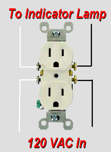

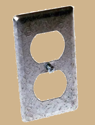

With the indicator lamp bracket and lamp in position, it was time to mount the 'handy box' to the back wall of the box. To check the fitting, I first mounted the duplex outlet to the box, plugged the fence charger into it and moved it about to find the best place to fasten the outlet box, marked it, took it all apart and screwed the Handy Box to the wooden box. Then I brought the extension cord into the box through a hole I'd drilled through the bottom and tied a knot in it (simple strain relief), ran the end through the cable clamp into the box and wired the ground, neutral and hot leads to the first set of screws. I wired the indicator lamp using a length of lamp cord and wired the lamp first, mounted it in the holder and ran the wires through the top cable clamp and to the top two screws on the duplex outlet. Then fastened the outlet to the Handy Box using the screws that come with the outlet and added a plastic outlet cover I had on hand. My original intent was to use a single outlet and metal Handy Box cover. However, at some point into the process I'd set it down near the drill press and forgotten it. When I came time to install the outlet box I couldn't find the parts I'd first found and had to dig 'round in my stash to find a duplex outlet and plastic cover. After I got them all installed and wired I found the first set near the drill press, kicked myself and moved on.
I had a length of Coaxial antenna wire I was sure could withstand the elements and was of sufficient gauge to handle the demands of the fence charger and my four foot run of 'fencing' and tried stripping the covering off to expose what turned out to be a rather brittle, copper clad(?) steel conductor - a real chore. I snapped the conductor a couple of times in the process but plowed ahead despite the warning signs. When I went to install the other ends (to the 'fence' and ground rod, I snapped the conductor twice again, surrendered and went with a length of red 10 gauge stranded copper and another in green
Step 5: Mounting and Connecting
As we had an outlet within about ten-twelve feet from the nest box at issue the easiest solution was to mount the fence charger box between the two. The wall was clad in rough-faced brick and wanted a special attachment solution and I thought to try a French Cleat which would allow the box to be suspended such that it would tilt forward and shed any rain that came our way by attaching a small 'foot' at the bottom of the box aligned with a low point in the brickwork so the bottom bottom of the box was closer to the wall tilting the box forward. Later, I drill a hole through both parts of the cleat to sort of lock things in place buy placing a bolt through the hole.
Then it was a simple matter to run the red and green wires along the bricks and nest box to the 'fence' wire on the perch where a screw, washer and wire nut served to make that connection while a bolt through a hole I'd drilled through the rebar served to fasten the green lead under a washer and nut as securely as needed.

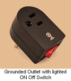

Shown is the white two-prong outlet switch first employed. It was a bit difficult to access what with the outlet cover trying to snap shut. So I replaced it with a three-prong (grounded) outlet switch that was easier to access as well as offering an illuminated switch.
