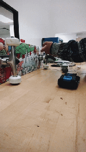

Step 1: Preparing the Wheels
  1. Choose one of the front wheels or one of the rear wheels to replace and act as the driving actuator with the belt (I chose to make mine a front wheel drive as I believe the torque would be enough and my design worked for me at around ~135 LBS. To leverage as much torque as possible for motion at greater weight, rear-wheel drive would be slightly better. ).

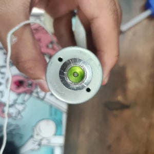

  2. Using your wrench, remove the nut and take the wheel off. You should see two ball bearings embedded within the wheel and the goal is to remove one of them in order to be able to accommodate the larger 60 Teeth wheel on the side.
  3. Using a screwdriver or some shaft to remove the ball bearing, use the dremel to round off and cut out the inner area slightly so as to be able to fit the nut inside of the area and allow it to tighten. By the end, you should be left with a hole similar to the hole I have in Image 3
  4. Take the wheel and put it side by side with the larger of the aluminum wheels it will be alongside

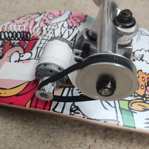

  1. Place some adhesive foam underneath where the motor will be mounted. Ensure that the end of the shaft of the motor is aligned with the aluminum so that when we add the attachment with fewer teeth and of smaller form, it is able to fit the belt horizontally.
  2. Place some adhesive foam onto the motor itself and place the mount on top of the motor
  3. Take two screws and on either end of the motor mount, drill them into place completely until the motor is secured
  4. Use a bolt cutter or another metal cutting tool you might have to remove the ends sticking out and possibly use a small bit of adhesive foam of the same color or just some regular tape on the other side so that the protrusions are not as noticeable and you do not make any contact with them.

  1. Glue the metal wheel with teeth to the actual wheel of the skateboard and then put it into the skateboard using superglue or some sort of Epoxy. Screw in the nut using something like a thin plier to be able to reach into the hole and secure the nut. It will be a small gap between the hole and edges of the nut, so the thin nose plier was one of the only tools I had that worked to secure it, but it is a fairly easy and fast process.
  2. To secure the smaller bearing onto the shaft of the motor, I designed and 3D printed a small attachment to adjust for the gap between the diameter of the smaller aluminum wheel and the shaft itself. I made it have a tight ft and it was quite secure, but you can use super glue or some other type of adhesive if you wish.
  3. You can then add the belt, leaving a small amount of slack so that it works optimally. If you tighten it completely, it would lead to excessive wear, stretching, or slippage, so I left a small amount of slack and that seems to work quite well in testing.
