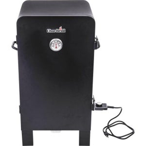

Back to the first point. Whatcha need? What we need is an insulated box large enough to fit what we want with the minimal compliment of electronics.The main thing you want is to find one that is analog. We're going to
add out own temperature controls that don't suck as much and you can actually replace when they go out with minimal fuss. Everything else we can fix. For me, I went with a Char Broil Analog Smoker. You don't need to get this one. If you want something bigger, get it. Size matters when you want to smoke a ton of stuff. Everything else in this instructable will still work. They aren't paying me (yet... Hint, hint Char Broil). I bought one off of Amazon for about $130ish. It was delivered because I'm just that lazy.

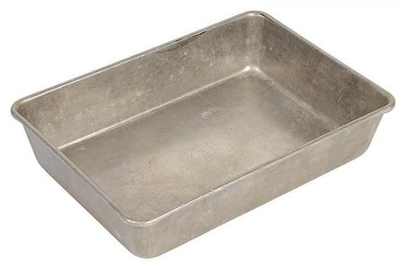

The water pan might be too small. It might not. On my smoker it's way too small. I don't want to open the door and fill it while I'm cooking. I can fill it any time I'm scheduled to mess with the meat, but it needs to hold enough water to get me there. I use a standard pan that holds around 2 quarts. It gets me through a full cook but if I need to top it up I can in hour 3 or 4. You want it low in the box, above the heating element. It will keep your meat moist and the density of steam will help keep the temperature steady as she goes.
