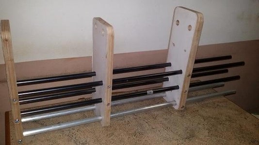

Step 1: Plywood Boards - Cutting and Drilling
We start with the plywood boards (n.1 – LIST MAT.) that need to be cut and drilled (Fig.1) as from drawing, see example of one pdf/dxf drawings list (Fig.2-4-5-6); in the event that it is possible to make a laser or mill cut, the cutting will be more precise for the benefit of a better assembly; the DXF drawings of the various wooden parts are used, they are 4 dwgs and 7 plywood boards in total (Fig.3-56-57 for boards type.
Step 2: Plywood Boards Assembly
Trace to measure (Fig.3 dimensions) the positioning of the various wooden components (plywood wooden crossbars) and the threaded holes of aluminum and iron pipes (n.2-3-4 – LIST MAT.) suitable for fixing the wooden components themselves using M6x40 screws, taking care to create a blind hole on plywood crossbar (Fig.9b) to house the head of the screw itself (Fig. 4-5-6-7-8-9).

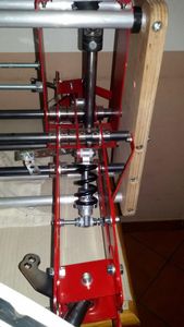

Step 5: Front Suspensions and Steering System Assembly
Before fixing the front wooden component (plywood board crossbar) it is necessary to complete the assembly of what concerns in order the footrest bracket (see Fig.28-29), the steering and the front suspensions, the latter made with wishbone arms composed of 3mm thick metal plates (Fig.22-23-24-25) and fixed to the chassis by steel shaft collars (n.20 MISUMI KSC2012 - Fig.45) with the same internal diameter as the 20x2 tube and equipped with an allen screw to prevent it from sliding inside the tube itself, see example of pdf/dxf drawings list (Fig.26-27).
Therefore, in order, the following metal plates elements will be inserted into the lower tubes 1, 2, 3 and 4 : footrest bracket (Fig.28 and pdf/dxf dwg Fig.29) locked with n.2 MISUMI KSC2012 and n.2 MISUMI KSC2512 (Fig.46) shaft collars (to lower aluminum 25x3 pipes), steering box made up of universal joints and the respective bearings n.2 MISUMI HBTP20 that we have already assembled, upper and lower flat wishbones (rear) of the suspension, front shock absorber support (Fig.30 and pdf/dxf dwg Fig.31), also made of 4mm flat bar metal, with the relative collars.
It is important to remember that lubricated Teflon bushings washers are installed inside the holes of the the wishbones bars that make up the front suspension (n.8 MISUMI GFM-2023-07 - Fig.47).
To complete the front suspension there is the assembly of the front shock absorbers (n.13 MAT. LIST) fixed with M8 screws to the shock absorber support and to the lower arm (Fig.32-33).
Once the 25mm thick. wooden structural component (plywood board crossbar) has been mounted to close the front of the chassis (pdf/dxf dwg Fig.34), the front wheel hub are mounted on the appropriately sized wheel hub holders in order to create a geometry suitable for obtaining the characteristic angles of the steering and the suspension itself (caster, camber, trail and scrub radius) (Fig.35-36-43), see example of pdf/dxf drawings list (Fig.37 - 4 pcs).

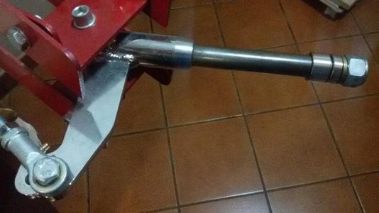

For the wheel hub you can use a wheel hub for 100cc karts (sk1075 right and sk1075 left - Fig.42) with a diameter of 17mm and an inclination of 10°, it involves adapting the hub of the 20" wheel of a bicycle by inserting the appropriate bearings or using an alloy wheel with the 17mm hub (Fig.38-39-40-41).
Furthermore, the kart spindle has already welded the bracket for the steering tie rods which otherwise would have to be built from scratch; here are linked the tie rods steering obtained from M8 threaded rod and two ball joints (n.4 MISUMI PHSC 8 - Fig.48); the wheel hub or kart spindle (Fig.49) it is usually supplied with all the pin (Fig.50), washers (Fig.51) nuts (Fig.52), bushings (Fig.53) and bearings (Fig.54).
