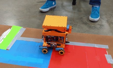

Our Project was to develop an Electric Vehicle charging robot to overcome some of the limitations of charging electric vehicles. There are ongoing research studies of automated robotics being utilized to charge electric vehicles in order to minimize user interaction with the pump. Our mechanical engineering department has a similar project that we used as a reference to ensure our drone ran efficiently. To make our robot unique, we utilized a square design, color sensors for lane detection, created code with MicroPython, and placed the scissor jack component on the top of the robot. Additionally, our vehicle isn’t large enough to charge an electric vehicle. However, our robot can be used to charge a cellular device. However, this robot can be developed at a larger scale to hold the correct charging components for an electric vehicle.
Our model is fully functioning and shows an understanding of how mecanum wheels, object detection, lane detection, robotics controls and processing from various sensors. Our vehicle can follow a lane to a charging point, charge at the station, then return from the station to rest at the resting point.

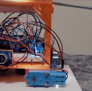

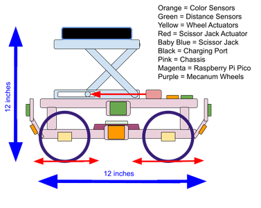

In our design some of the components we incorporated are the Raspberry Pi Pico, Motor Drivers ‘H-Bridge- L298 Module’, Grove Distance Sensors, 6V Battery pack and two TCS34725 Color and Light Sensors. Our vehicle is modular, so the lower part of the vehicle is the drive and main sensor compartment, with the upper section being used to actuate the scissor jack. We need to be able to detect lane changes, so a color sensor was determined in order to meet this objective. It does so by detecting the HUE value of the floor in which the robot rolls on, and based on this color it will actuate the mecanum wheels in a specific direction. Mecanum wheels are wheels with an omnidirectional design in order to allow vehicles to move in any direction. In order to achieve the direction changes of the vehicle, we needed 4 mecanum wheels connected to two drivers. One driver ran two of the same mecanum wheels, whether it be the left or right, in parallel. The voltage required to run this system made one of our additional objectives to find a battery system that controls the pico and the drivers separately. The mecanum wheels when run in the system can cause the vehicle to go forwards, backwards, strafe left, and strafe right. Then we wanted to make sure if the vehicle approaches an obstacle or wall, it doesn’t proceed to run into it. We utilized a distance sensor on each side of the vehicle in order to detect objects approaching and prevent the vehicle from crashing. We also connected LEDs into the system and utilized the Maker Pi Pico’s speaker in order to give information to the user of what state the vehicle is in and what it is detecting. This includes whether an object is detected, a color is detected, a charging point is identified, or the resting point is identified.

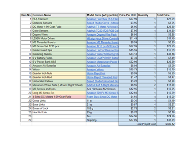

Please see the budget attached for the referenced supplies.

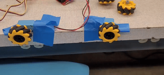

Step 1: Mecanum Wheels (Omni-Directionality)
In order to actuate the mecanum wheels properly in the ideal directions the two left wheels would need to be diagonal from each other and vice versa for the right wheels. Both wheels of the same type would need to be connected in parallel to the driver, with the opposite black cord of one motor being placed in the same port as the red coord of the motor on the other side diagonally. This is to keep the wheel mounts the same position to make printing easier and to get the necessary drive. In order to drive the motors, we used the L298N drivers and set the ENA, IN1, and IN2 into the GPIO pins of the pico. We defined four functions for up, back, left, right and stop in order to easily understand the final code functionality. The states in the final code call on the functions in order to drive the robot.

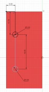

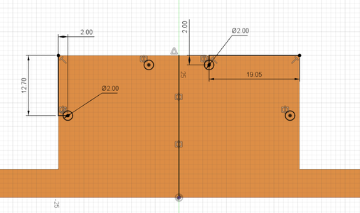

Step 2: Mecanum Wheel Mounts
Based on the part file specifications, we created the mounting holes for the DC motor onto the shape to allow it to sit against the part and spin with no tolerance issues. Additionally, we added two screw holes on the top that way we could attatch to the base plate.

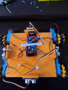

Step 3: Ultrasonic Distance Sensors (Object Avoidance)
In order to avoid collisions, object detection using ultrasonic distance sensors was necessary. Four sensors are placed with one on each side of the Charge Bot. The sensors are polled by the sonics() function near the start our code, which reads each sensor sequentially, compensates for read errors, determines the closest reading, and then returns the closest distance, the name of the sensor with that reading, and a list of all four readings as a 3 item tuple. The main code then calls this function within both movement loops (states 2 and 4). If the minimum reading is under a set range, it will then determine where it fits within 3 further ranges. Based on these values it will display the distance when running under the computer and stop all movement. The bot will also light all 4 indicator LEDs and beep a different tone for each of the 3 distance ranges, as shown in Figure 5. If no object is within a concerning range, all the distance readings are printed along with the current state and color reading.

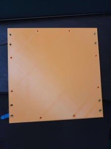

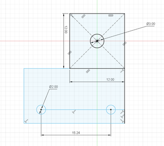

Step 4: Bottom Base (Sensor Mounts)
The dimensions for the hole inserts of the top of the mecanum wheel mount was used on the bottom base to mount the wheels properly to the frame. From there we added extrusions for the distance sensors mounts, which we then extruded M2 screw holes to fasten the part to the frame. We also added a couple temporary screw holes that came in handy later for mounting the color sensors.

In order to actuate the robot, battery specifications needed to be met. A 5 volt power bank was needed to drive the microcontroller and the components powered by it. A 6 volt battery pack was needed to power the drivers. In theory the charging port for the phone can be connected to the extra USB in the power bank for the pico.
Step 6: Top Base (Scissor Jack Mount)
We reused the structure of the bottom base for the top base to have structural uniformity and ensure that the vehicle remained easily modular. Additionally we created a support overhang to ensure the tower was rigid and printed at a high infill. Additionally, because the DC motor needed to be mounted to the frame, we created an offset piece that holds the motor as shown in the fourth image. It is similar to the mecanum wheel mount just extended on the bottom to attach between the tower and the plate.

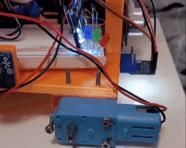

Step 7: Scissor Jack (Powering Station)
As the scissor jack utilizes the same motor type as the mecanum wheels, the code follows the same formatting for the jack as the mecanum wheels by defining 3 functions, “scissor_up”, “scissor_back”, and “scissor_stop” in order to actuate the jack. We did manually testing with various weights to determine the time to actuate the jack from the retracted to extended state, as we weren’t able to utilize the stepper motor we had purchased due to a low torque rating.

Step 12: Sizing and Tolerance
In order to 3D print the mechanism and allow for the ideal movement, particular sizings and sensible connections must be accounted for. We utilized M3 Screws as joint rods for our mechanism. In order to be a tight fit into parts, a 3 millimeter hole must be inserted. In order for a loose fit into parts, a 3.25 millimeter hole was needed. For the cross links and the slider slots, a 3.25 millimeter hole was needed. This would allow the jack to rotate freely. For the cross links and the rotating points on the bases, a 3 millimeter hole was needed. Additionally, the distance between the cross links in the CAD model is 4.5 inches, but in the physical model a 4.49 cross link is used to allow the cross links to not be a tight fit around the system.

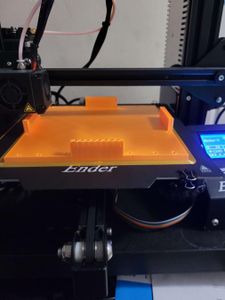

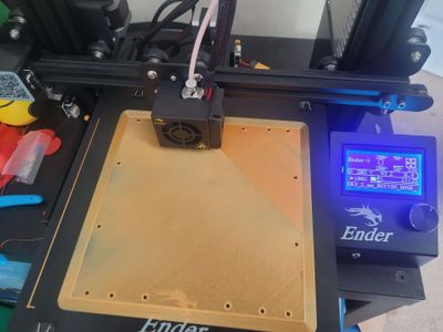

Step 13: 3D Printing
We utilized an Creality Ender 3 printer to make all our parts. This was the main constraint for the size of the project, as we designed the entire model to fit within the space of an Ender 3 so we could print at home rather than taking up the club printers while other students were trying to print.
Every part was created with a 20% infill at a cubic format to be strong enough to withstand the weights of the objects attached while also having relatively small print times.
