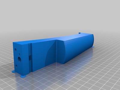

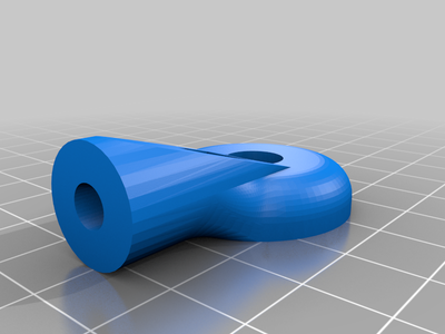

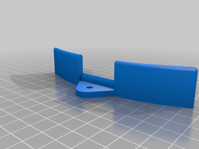

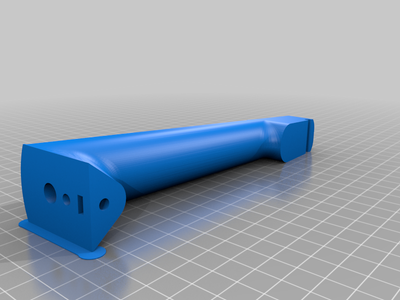

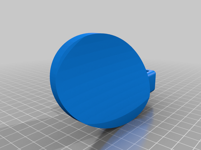

Step 1: 3D Models and Prints

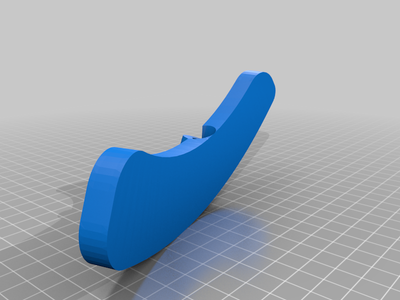

We didn´t create the models ourselves, we used this website. The different parts of the violin that we printed were the neck, a handle, the chin rest, and the shoulder rest. The neck was separated in 3 different parts, since is the biggest piece.
On the website you can find the necessary files to print the parts for yourself.

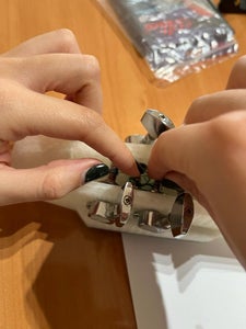

First, we are going to connect the neck, two of those pieces are attached by a metal bar, as shown in the pictures. The strings are screwed in the head of the neck. The last part of the neck, where we will be putting the pegs and pre-amplifier, is connected with the middle part with some bigger screws.
We already have the main structural part of the violin done. We put the pegs in their place and the next step is to connect the bridge to the pre-amplifier. The wire of the bridge is welded to the board of the pre-amplifier. You can change some parameters, like the volume or tone, and you take the signal out to your computer, so you can record it, with a cable, or you can even connect it to a speaker.

Secondly, the shoulder rest was not very comfortable, because it wasn´t adjusted. If you want to try and recreate this violin, you should take measures and adapt a little bit better this rests.
