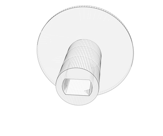

Step 1: The Design
The first thing I did was trying to figure out how the lamp was bending. A fishing rod came into my my mind. The rod is straight when it has no weight on it, but when you catch a fish the rod starts too bent.
So keeping the fishing rod in my mind I started to design the lamp. The first idea was to use knee joints on top of each other with protrusions where the threads can pass through (figure 1,2,3).
This wasn’t stabile enough so instead I used a flexible tube that was stiff enough that it wouldn’t collapse but it could bend.
To pull the strings tight I used 5V stepper motors wich where driven by drivers wich on their turn where driven by an Arduino.
In 123D Design I designed a mount for the stepper motors where the string can get turned around (figure 4). I also designed a mount where the string goes through to bend the flexible tube (figure 5).
