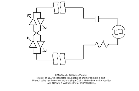

1. LEDs - Anywhere from 2 to 30.
2. A ceramic capacitor 0.22 uF (of number 224 K, rated for 400 VAC) if your country provides 220 VAC. Or a 0.47 uF ceramic capacitor, if on 110 V AC Mains.
3. Single resistor of one kilo-ohms, BUT RATED FOR ONE WATT OR HIGHER (Lower wattage resistor will BURN on AC Mains).

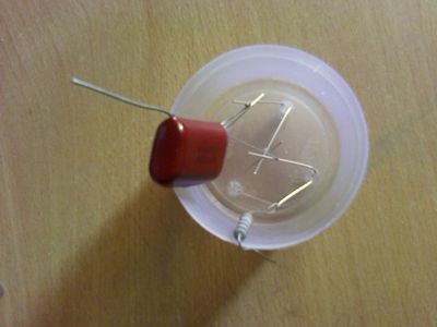

4. Just plain simple electrical tape! Or waste plastic box, or a container or pet bottle....
5. a male pin or a bulb base - depending on whether you want to make a pin LED or a bulb LED.

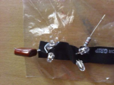

Step 2: Assembly:

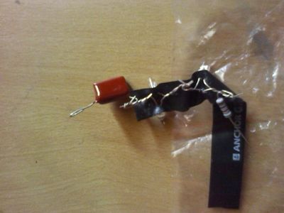

Just connect positive of one led to negative of another LED - such that each end has a positive and a negative.
This forms one LED pair.
Insert / Pierce an electrical tape with this pair.
You can link-up 15 such pairs.
The two ends that remain, finally are connected to a resistor and a capacitor.
The resistor and capacitor go the the male plug or a bulb base - depending on whether you want to make a pin based led or a bulb led.
