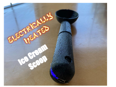

Step 1: The Idea
The goal is to have a scoop that slices through the most icy of ice creams with ease–basically the ice cream scoop equivalent of Excalibur. Heated ice cream scoops exist already, but many are hand-heated or not battery powered. Most, if not all, are not dishwasher safe, either, which is hopefully (eventually) something that this project will address. They all also heat the entire scoop so that the ice cream inside the scoop melts excessively. To counter this, only the edge of this scoop will be heated so that you can scoop the ice cream and leave it in the scoop for a while before it melts.
In regard to the actual design, the physical scoop will look like a normal ice cream scoop, except with a hidden heating element wire under the edge. The wire I used was Nichrome 80 wire, which, from the sources I’ve found, seems to be nontoxic. Regardless, since the wire is inside the scoop, it shouldn’t come in direct contact with food. Since batteries are most definitely not dishwasher safe (don’t test this please), to clean the scoop we’ll have to remove the battery/components compartment. The plan is to fit the battery and components in the lower part of the handle, so that we can remove the scoop and upper part of the handle and put it in the dishwasher (ice cream shouldn’t get as far down as the lower part, so you shouldn’t even need to clean this anyways).
I will use a 1600 mAh 18500 battery for this project, which should give the scoop around an hour and a half of battery life (based off of extremely rough and maybe flawed current calculations). Unless you work as a professional ice cream scooper, this should be sufficient, and even if you do work as a professional ice cream scooper, you can make extra battery compartments to switch out when one runs out. While you’re using one, you can charge the others (you can also just keep the scoop plugged in). Since USB-C is all the rage these days, this is how the scoop will be charged.
To transfer power between the handle segments, I’ll use two-pin dupont wire connectors, male in one segment, female in the other.

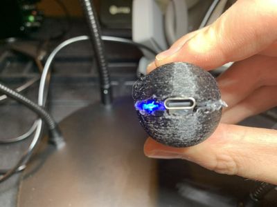

While we’re on this sketch, we might as well design the USB-C and LED ports. Centering it on the centerpoint of the circle, draw a center rectangle with the following dimensions (wow, that was a lot of centers): a width of 9.4 millimeters, and a height of 3.4 millimeters. This should give you plenty of clearance in the case of an inaccurate printer. Mine is extremely inaccurate, so it may even give you too much allowance, which is why you should make these into parameters that can be edited later. Next, filet each corner of the rectangle with a radius of 1.25 millimeters. Make this a parameter as well. USB ports are always some of the hardest parts of a design to get right. It’s surprisingly difficult to find the right dimensions online, so these values mostly come from some handy digital calipers and trial and error. You can also draw another rectangle around the USB-C port to serve as a place to put the glue that will keep the port in place. Extrude the USB-C outline so that it cuts into the handle, and extrude the other rectangle (with the USB-C port cut out) in a join operation into the handle as well. I extruded mine 10 millimeters and it worked well. (One note: you can make extruded values negative to switch their directions). Don’t worry if a part sticks out of the handle, we’ll fix this later.
Next up are the LEDs. These are optional, but a good idea to have. If you choose to put them in, we need an LED to indicate that the scoop is on, and one to indicate the state of the battery when it’s charging. Most rechargeable battery boards don’t have a place to add either LED, so we’ll have to integrate them into the circuit we make. I couldn’t figure out how to add the latter LED without microcontrollers or other complex parts, so I dropped it from my circuit design. I still added it to the handle design, though, in case I wanted to add it in the future.
I have 3 millimeter LEDs and 5 millimeter LEDs. Either size will work, but the 3 millimeter ones will leave more space for wires and components. For this reason, I decided to go with the smaller size. On the same sketch containing the USB-C port, create a two-point circle. Place the first point on the midpoint of one of the shorter sides of the USB-C port (the midpoint may be difficult to find, as the shorter sides of the USB-C port are quite small, but you just have to zoom in a lot). Place the second point a certain distance away, taking care that the line you are making is straight. You want the diameter of the circle to allow for the size of the LED and its enclosure. A 7.5 millimeter enclosure worked for me, but this makes the wall of the enclosure 2 millimeters thick, which is excessive. The other 0.5 was to make sure the LED fit in its enclosure. 1 millimeter walls are enough, so if you’re using a 5 millimeter LED, 7.5 is still a good value. In the center of this circle, draw a circle with a 1 millimeter diameter. If your printer is very inaccurate, or if you’re printing the handle with its base on the build plate (which I’d recommend), you may want to increase this to 1.5 (printing the handle base-down can cause first layer squish, which could mess with the LED aperture’s diameter). Repeat this process on the other side, or use the Mirror function, if you want another LED. To mirror, you’ll need a line to reflect over, so draw a vertical line from the bottom of the circle to the top. This line will come in handy later, as well.
Extrude the LED aperture holes all the way into the handle. Extrude the enclosure a certain distance into the handle that will allow for the LEDs to fit inside the enclosure without falling out. 10 millimeters worked for me. Again, don’t worry if part of the enclosure sticks out beyond the wall of the handle, this will get fixed later. You can definitely leave the LED enclosures like this, but if you wish, you can do a double sided extrusion with the inner circle to make the front wall of the enclosure flat. Just make sure the distance between the outer handle wall and the inner LED enclosure wall isn’t too thin.

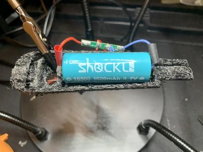

The circuit for this project is pretty simple, thankfully. A 1600 mAh 18500 3.7 volt rechargeable lithium-ion battery provides the power. It must be protected by a battery protection circuit (BMS (battery management system)), which prevents the battery from overcharging or over discharging (basically it prevents it from exploding, which is nice of it). The BMS is connected to a USB-C female port for charging. The output is connected to an on/off switch and an indicator LED to show the user if the scoop is hot or not. The on/off switch is connected to dupont connectors, which allows for connection to the resistance wire. The above diagram shows this (sorry electrical engineers, it’s not in the standard format. I thought this would be confusing for beginners).
The polarity of the dupont connectors doesn’t matter, so don’t worry about this. The circuit diagram for the scoop part of the handle is pretty simple, so I didn’t draw it up. Basically, connect the terminals of the heating wire to the dupont connectors. I never tried to put the heating wire directly in the dupont connector, but this would probably be fine. It would also eliminate the need for solder, which could create toxicity issues if it is washed in the dishwasher (I’m not sure but I would assume. If you’re going to risk it, definitely don’t use lead solder).

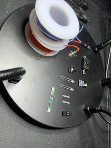

Step 11: Soldering

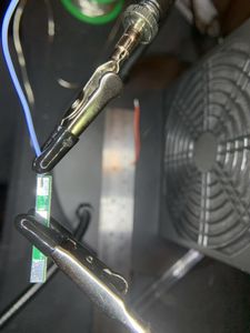

A note on heat shrink: Heat shrink is a sheath you can buy that shrinks around wires when exposed to heat. It’s useful for protecting bare wires and solder joints, and may be especially important for the battery terminals in this project. One consideration, however, is that it limits the wire flexibility, which is important for the project. For this reason, I didn’t use it on every joint, and instead relied on the incredible insulating power of hot glue.

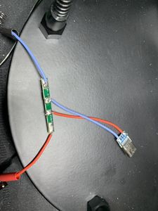

Begin by soldering two wires to the positive and negative battery terminals. Using red and black wires helps with organization. I used red for positive and blue for negative, since I didn’t have black. In this case, the negative wire must be much longer than the positive wire, but make sure neither are too short or too long. When in doubt, measure your wires roughly by looping them around the enclosure in a rough approximation of their final positions. I used the spring piece as the negative terminal and the flat piece as the positive terminal. Next, solder the end of the wire attached to the positive terminal to B+ on the BMS, doing the same (but opposite) with the negative terminal’s wire.

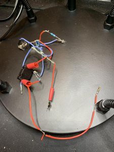

Next, twist two short red wires together and solder them to P+. Connect one of them to the USB port’s V, and the other to one of the switch tabs. Next, twist two short black wires together and one long black wire (make it long enough to stretch across the entire battery compartment). Solder this to P-. Solder the two short wires to the USB port’s G and the negative LED pin. Leave the longer wire for now.
Next, twist one short red wire and one long red wire together (long enough to stretch across the whole compartment) and solder them to the other switch tab. Solder the shorter wire to the resistor. Then solder the other resistor pin to the positive pin of the LED. This should be the last of the soldering.
Crimp the two longer, unconnected wires into female dupont connectors. Be careful, though, this is hard at first. I had to practice 3 or so times before I could get it right, and I watched this video beforehand. Once you’re done, put these wires into a 2 pin female dupont enclosure. Repeat this for another two wires (if you don’t just put the resistance wire straight into the dupont connectors). This will be for the scoop side of the handle. If you didn’t use the raw resistance wire in the dupont connectors, solder or connect in some other, more food-safe manner, the ends of the dupont connector’s wires to the ends of the resistance wire.

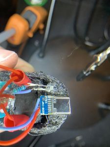

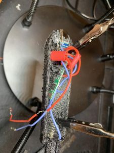

Step 12: Construction
*I used a hot glue gun for all this, which worked well.*

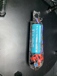

Grab the side of the handle with the button enclosure on it. First glue the negative battery terminal to the side closest to the handle coupler. Glue the positive terminal to the part that juts out from the button enclosure. Take care not to tangle any wires, and don’t use too much glue. This could cause there not to be enough space for the battery (it’s a tight fit). At this point, you can test if the battery fits, making sure that you don’t reverse the polarity of the battery by accident by placing it in the wrong orientation. At this point, check that the led works as well. If it does, it’s likely the project is a success! If it doesn’t, don’t despair. Failure is a part of any engineering project, and it’s what leads to growth. Edison failed 1,000 times before creating the lightbulb, so if you fail once you’re still a better engineer than him (I think this project is a great comparison to that, if not harder, right? ;).
If it fits, you can move on to gluing the other components in place. Fit the switch in and glue it down, doing the same with the LED and the USB port. If you didn’t put heat shrink on the LED pins, make sure they are short-circuiting (touching) before you glue them. If they are, just manually move them apart and put glue in between.
Next, fit the battery in. You may need to rearrange the wires attached to the battery terminals. There should be a little space in between the battery and the edge to fit the BMS in. Stuff it in that space, or any space available, and glue it to the side of the handle, not the battery. Finally, loop the dupont wires around the battery and into the space we made for them, making sure that the holes are flush against the outside of the handle coupler.

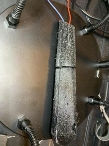

Now, try to fit the top part of the handle over all the components. If it doesn’t fit, check for wires sticking out around the edges, or rearrange the inner wires so that they are compact and away from the edges. When they are sufficiently contained, put a little glue around the entire edge and on the USB port and the dupont connectors (not too much glue on these last two, though. I made this mistake, and there was a big glue gap between the handle sides in my finished project). Press the halves together and hold it for about a minute.

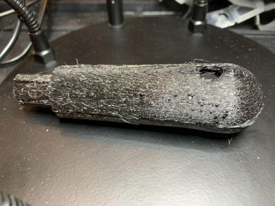

Glue the button print to the actual switch, being careful that you don’t accidentally glue it to the side of the handle, rendering it un-pressable. Test the strength of the glue seal, and move on to the lower handle.

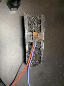

Glue the male dupont connectors into the provided space like with the other side of the handle. Liberally apply glue to the scoop coupler and slide it into the handle. Make sure it is firmly connected. Next, put glue around the edges of the lower handle prints and press them together for a minute or so.
Test that the duponts connect well and that the scoop heats up when the button is pressed. If it does…
You’re done! Congratulations! You now have a working heated ice cream scoop. I hoped you learned a lot and enjoyed the build, now happy scooping!
Notes on the scoop's performance: Sadly, I did not get the chance to test the scoop on real ice cream before I left on a family trip. That being said, when you turn the scoop on, the edge gets quite hot, maybe even too hot. Considering that other heated scoops claim to cut through ice cream well with a fraction of the temperature that this scoop reaches, I expect that the scoop shreds through even the most frozen ice cream easily. Truly a victory for the arthritis victim and the weak-armed alike! If you find that the scoop does get too hot, you could try a larger resistance wire gauge, or you could also try adding resistors of different values to reduce the current that passes through the scoop. I haven't tried this, so I don't know if it works, but I assume it would.
