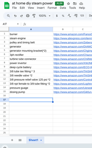

No welding is needed - just sheetmetal, 6mm tubing and misc plumbing parts. full update supply list with links to where to buy are at wastefree23.org/shack/supplies
