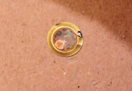

Step 3: Find a Piezo
Here's a piezo from an old microwave.
You can find one of these in pretty much any appliance that makes a beeping sound.
We're going to only need the piezo element, so carefully remove the plastic housing if it has one.

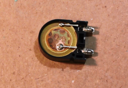

Step 4: Make a Small Potentiometer
Here's the variable resistor that I'll be using to make our potentiometers with.
I cut a piece of credit card to fit the cavity.
Then I glued it down in place with a dab of Krazy glue and cut it down to a half centimeter in length.

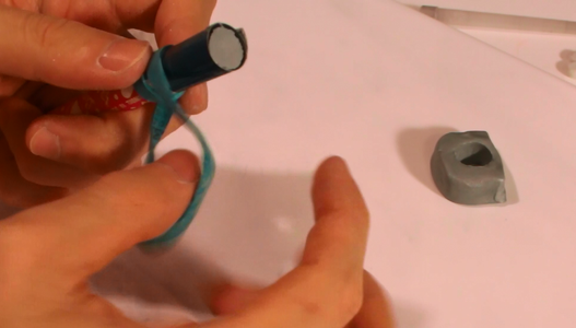

Step 5: Make a Tool to Cut Knobs
To make the clay knobs, we'll have to make a tool to cut out polymer clay,
I took the tube from a pen and wrapped around it a piece of aluminium that I cut from a soda can.
Hold the aluminum piece in place with an elastic and slide it out about 2 centimeters.

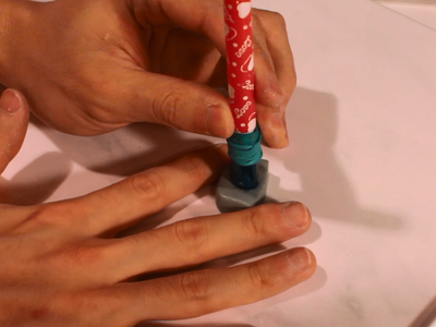

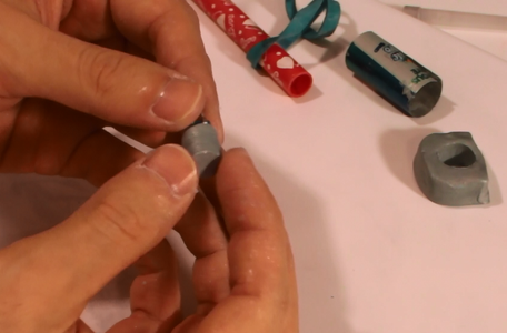

Now we roll out some polymer clay to about a centimeter in thickness.
Put our variable resistor into the clay as far as the knob needs to go.
Then slowly push and twist the cutting tool into the clay around the resistor.
When we reach the bottom, undo the elastic to release the clay.
Now we can carefully remove the resistor.
After we cut out two knobs, we'll set it on a plate and bake it in the oven at 250F for 30 minutes.

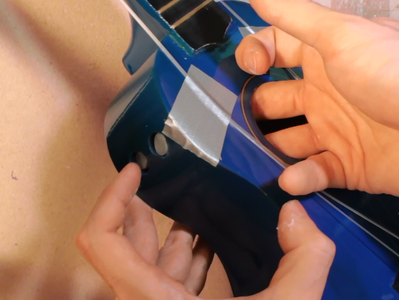

Step 9: Drill Holes
I sliced open a tennis ball and used it to hold the ukulele in place.
First make a small hole with a nail and hammer.
Then make a bigger pilot hole with a small drill bit.
Then, using a stepper drill bit, make a 1/4" hole.
After that I took some blue acrylic paint and painted in the holes.
In total there's three holes drilled - there's two holes on the side for the knobs, and one in the back for the output jack.
