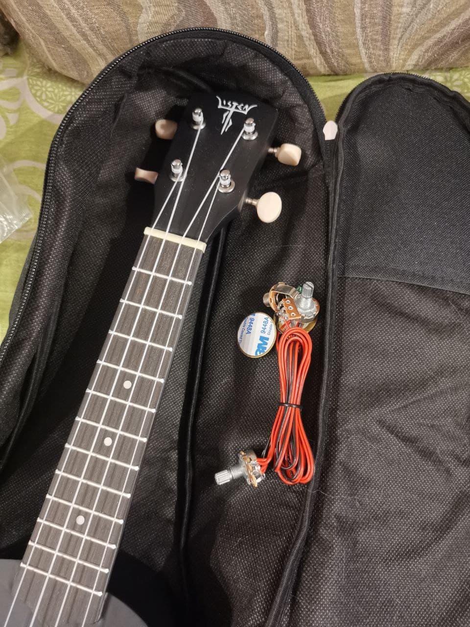

My kid loves to play ukulele, and one day I've got an idea to make it electric.

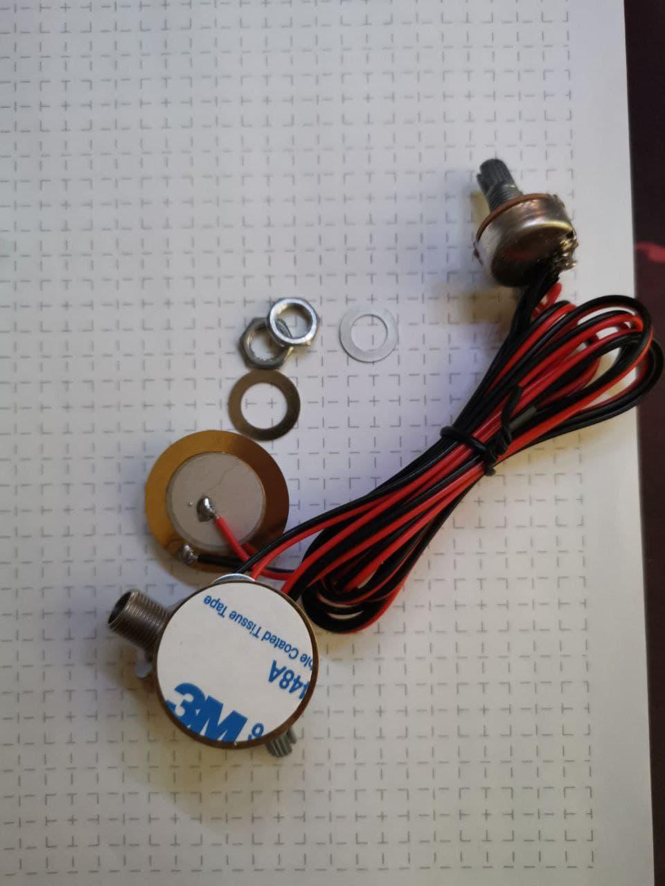

Since strings are non-metal - piezo pickups should be used. I've found all necessary hardware on Aliexpress.

Step 3: Stick Piezo Pickups
- Take off 3m tape cover
- Stick 1 piezo to the top inner side
- Stick 2 piezo on the bottom inner side
