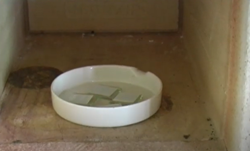

Step 2: COOKING OF THE FTO GLASSES
  • The muffle furnace, preheated beforehand, will have reached a temperature of 450°C at this point and will be ready to bake the glass slides;
  • place the slides in a porcelain crucible;
  • bake in the muffle furnace at 450°C for 30 minutes.
