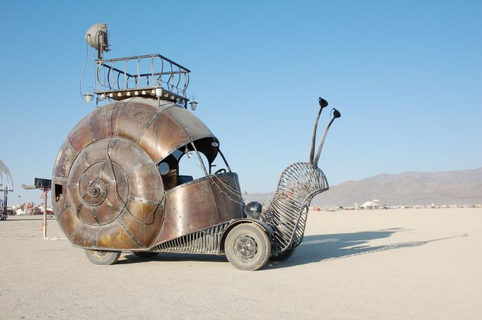

The Golden Mean a Giant Iron Snail Car

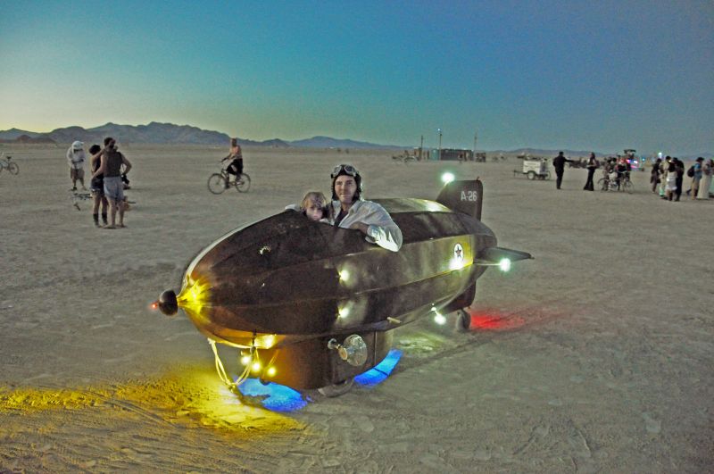

Zeppelini
