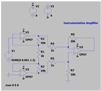

Step 1: Designing the Instrumentation Amplifier
The first component of the model is an instrumentation amplifier and it aims to amplify the incoming signals, which have a very low voltage. Since, the normal amplitude of an ECG signal is 1mV, we will design a amplifier with a gain of 1000 to obtain an output ECG signal between 1-2.5 V. The instrumentation amplifier is beneficial because it eliminates the need for input impedance matching, and consists of low noise, very high open loop gain and very high common-mode rejection mode.
Designing the Circuit using LTSpice
We first designed and tested our circuit in LTSpice (figure above).
Op amps 1 and 2 (U1 and U2) are non-inverting amplifiers that form the input stage and op amp 3 (U3) is a difference amplifier that forms the output stage of the instrumentation amplifier.
We also wanted to ensure that the gain of each stage was comparable (to protect the user if the system is connected to a person by preventing all the gain from happening in one place) and that we used R values in the kOhm range
We used the following calculations
Gain of Part 1 = (1+ (2 *R2) / R1)
We choose R1 = 2k Ω and R2 = 49k Ω. Hence, gain of part 1 = 50
Gain of Part 2 = R4 / R3
We chose R4 = 20k Ω and R3 = 1k Ω. Hence, gain of part 2 = 20
Overall Gain, Vout / (Vin2-Vin1) = Gain of Part 1 * Gain of Part 2 =
(1+(2 * R2) /R1)* (R4 / R3) = 50 * 20 = 1000

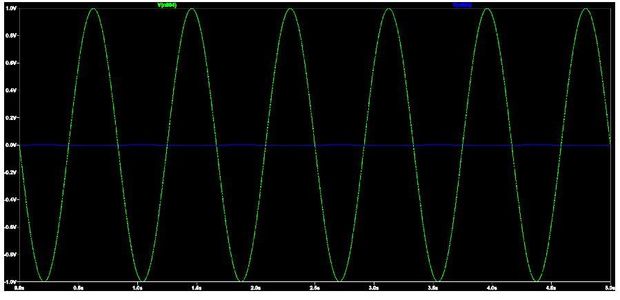

In LTSpice, we carried out a transient analysis of a sinusoidal input signal of 1 mV at 1.2 Hz to confirm a gain of 1000. An image of our results is included.

  1. LTSpice Simulation
An image of our results was uploaded and a output voltage of 1.0 V was observed for an input voltage of 1 mV, indicating a gain of 1000.
