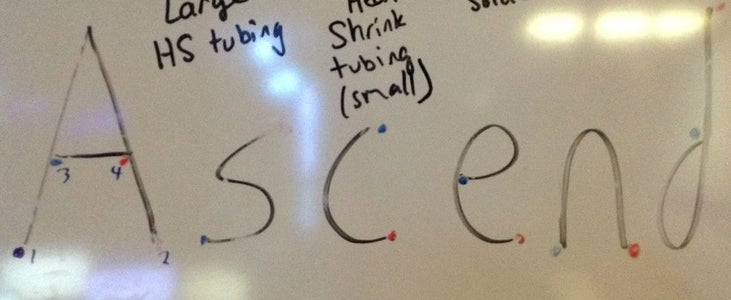

Step 1: Draw Your Design
The first step to a glorious, glowing sign is to draw what you want the sign to be.
Be sure to: Draw to scale
Figure out how you want to lace el wire from front to back in order to form letters without visible connections (hide from back of board)
I have drawn my design to scale and the blue dots represent coming out the front of the board, and red dots represent wire going through to the back of the board. I drew on a dry-erase board to easily change my design before I settled for a final draft.

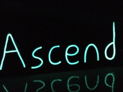

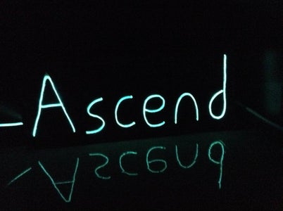

Step 8: Done With Sign Construction!
At this point, your el wire should be held in place and your sign should be the way you want it to look.
Step 9: Plug in Your EL Wire.
You can then plug your el wire into your battery/inverter and the el wire should begin to glow.
Step 10: Tada!! Done!
Tada!! You’re done! Now you can place your sign wherever you want, adding a cool piece of art wherever you want!
I was very satisfied with the end result of my sign. Just make sure you have enough wire to lace through your sign!!
