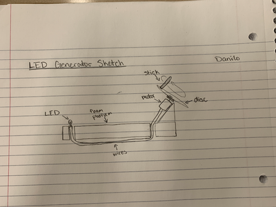

Start the project with a 10"x5" foam platform. Make a ramp piece that can fit the motor and be inserted into a pre-cut hole in the main platform.
Step 2: Step 2
Make a handle from popsicle sticks and hot glue it to disc.
Step 3: Step 3
Attach motor to center of disc, and connect LED to the wires of the motor.
Step 4: Step 4
Connect motor to ramp and connect ramp to platform. Route cable through opening that goes under that platform.
Step 5: Step 5
Cut out a slit at the end of the platform and wedge the wire and LED in there.
