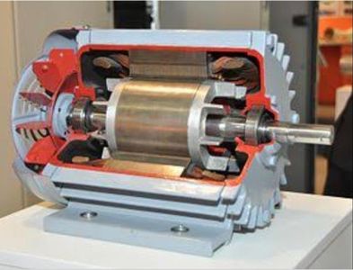

Electromagnet have been in wide use since their invention in 1825. From motors to MAGLEV trains to television sets... they are everywhere.
This is a fun project, exploiting the strong repulsion of like poles to create extreme accelerations as in Large Hadron collider.
So let us embark on a journey making this wireless electromagnetic spinner.
