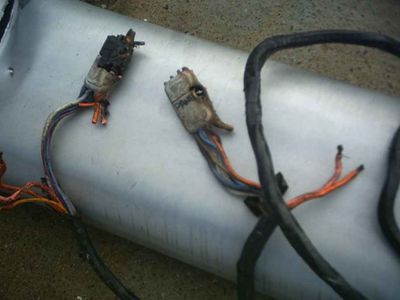

I made this analog circuit for two reasons. One: To stop my wires from melting due to too much current. Two: To limit the load on the alternator. Instead of the lights on a trailer going through the tail light circuit on the vehicle, which caused mine to melt, It will pull current directly from the battery using relays to switch. The entire circuit is 12V operated. Contains three 12V inputs, two 12V outputs, one Negative input.
These pictures show the circuit and some melted wires similar to what I had to replace.
