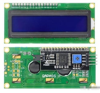

16×2i2c LCD display

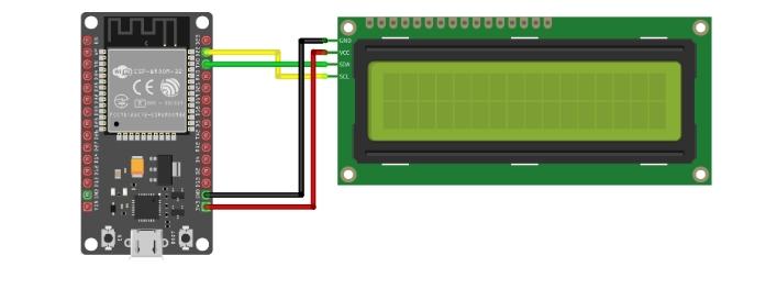

Schematic diagram
The schematic for this project is relatively simple as we are only connecting the LCD to the doitdevkitv1. Since we are using I2C for communication, we will connect the LCD's pins to the DevKit's I2C pins. Connect the parts as shown below.
A pinout diagram showing how the components are connected is shown below.
LCD–ESP32
GND - GNDVCC - 3.3v/VinSDA - D2(GPIO4)SCL - D1 (GPIO 5)
Due to the LCD's power requirements, it may not be bright enough when connected to the ESP32's 3.3v pin. If this is the case, connect the LCD's VCC pin to the ESP32's Vin pin so it can draw power directly from the connected power supply.

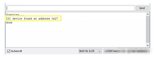

Before writing code for your project, know the I2C address because without it we will not be able to talk to the display.
While some LCDs have an address displayed on them or an address provided by the seller, in the absence of an address you can determine the address using a simple sketch i.e. an I2C line to detect the one connected next to its address equipment. This sketch is also a good way to test the correctness of the wiring or determine if the LCD is working properly.

This sketch basically uses a "for" loop to generate a list of addresses and then sends a begin transmission request to the addresses. The return value of the Write.endTransmission() function shows whether a device exists at that address. The address that receives the response is the address we are looking for.
Verify and upload the code to the ESP32 board and open the serial monitor. You should see an address like the image below:
Device address
If you keep getting "no device found" then take a look at these connections to make sure you're not confusing things, you can also go ahead and try 0x27 as the I2C address. This is common to most I2C LCD modules from China address.
