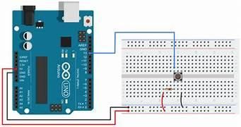

Step 2: Set Up the Circuit
Place the 7 LEDs on the breadboard in a pattern resembling a dice face.
Connect one leg of each LED to the Arduino's digital pins (e.g., 2, 3, 4, 5, 6, 7, 8).
Attach the other leg of each LED to a 220-ohm resistor, then to the ground (GND).
Connect a push button to a digital pin e .g. pin 9 and the ground.
