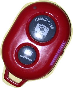

AB-Shutter3 is a camera shutter button for smartphones.
AB-Shutter3 connects to the equipment with bluetooth.
AB-Shutter3 is sold at Daiso in Japan (as of 2017).
