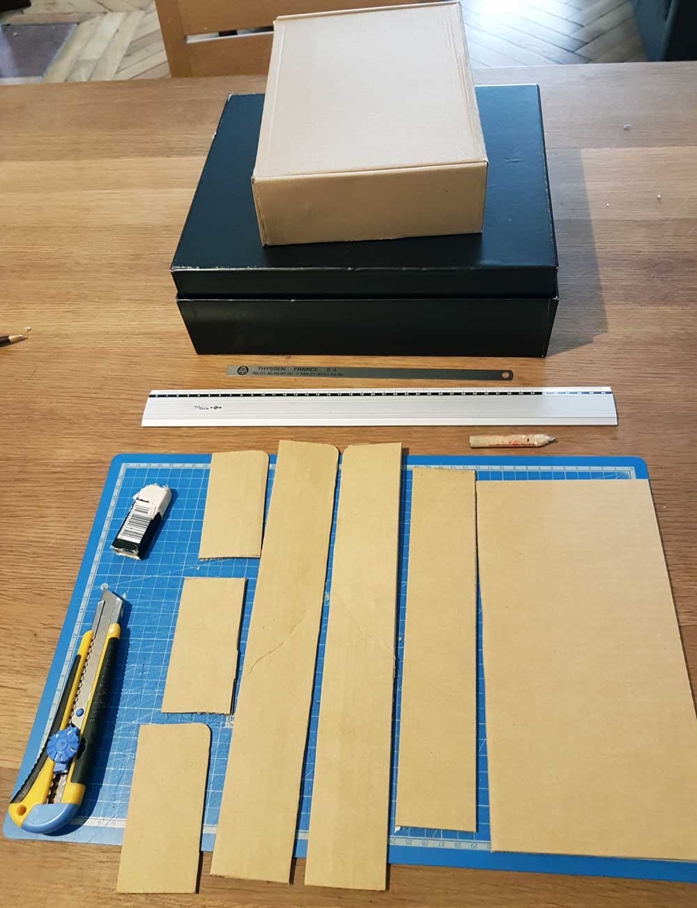

What you will need
- Utility knife
- Cardboard (I used my new printer box in this I'ble)
- Pen
- Ruler
- A shoe box (mine is about 32x26x10cm)
- Another box (mine is an electronic delivery box I had when ordering some parts for my on-going ARDUINO prototype)
- glue gun with hot glue
Note: Your own design will highly depend on the boxes you will find.

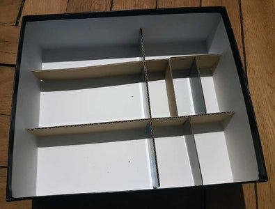

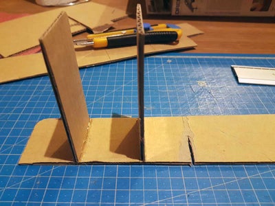

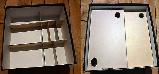

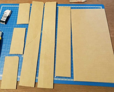

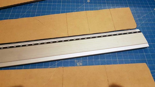

My shoe box is 10 cm high so I decided that my first level would be 5 cm. Thus I have cut bands of cardboard that are 5 cm high. According to my storage strategy I have:
- 2 bands of 32cm,
- 1 of 26cm,
- 2 of 10cm,
- 1 of 6cm.

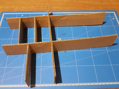

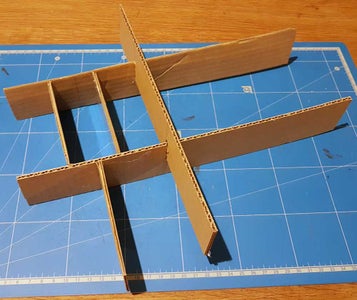

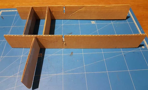

Once cut, position the notches on the 32 and 26 cm bands in order to connect them.
Hot glue the 10 cm and 6 cm band on the 32cm ones to create the storage areas.
Connect the 26cm using the notches. Your lower level organizing structure is done.
Position it into the shoe box to validate your work.
You can fix it using hot glue if you like but I would rather wait until all designs are validated. However it could help you to go faster later on.

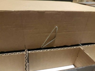

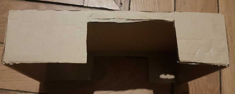

As your prototyping area will top the left side of the storage area, you have bands running under.

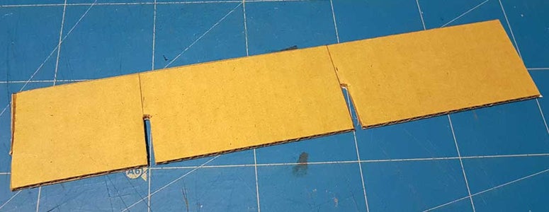

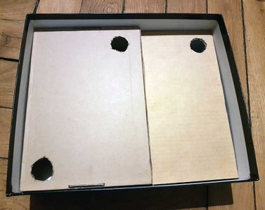

Report the position of the bands using your pen on the electronic box. Remove the cardboard in order to obtain a hole that will allow the box to top this area. I cut the sides with a little angle to ease the folding.
My electronic box is 13x32 so I cut a sheet of cardboard of 10x32 cm to top the right-hand side.

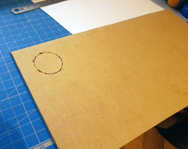

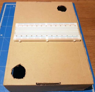

Using a water bottle stopper, report a circle on both the sheet and the prototyping area. This will be the grabbing holes. Those holes are made to ease the use of those parts.

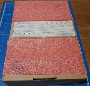

Take a ruler and a pen and determine the middle height of the prototyping area. Use the tape that is under most breadboard to glue it right in the middle of this area.
I used foam to support my electronic boards (Arduino). Once the foam glued on the top of the area, I sand just a little the cardboard to eliminate all remaining rough edges.
Use the given screws to position your board on the prototyping area, not to far from the breadboard but not too close neither.
We are done with the prototyping area.

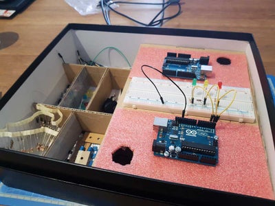

Step 4: Final Result
Ready to prototype?
I am.
All my electronic components are now safely stored in the box. I can pack and unpack it quickly without dismantling my mock-up.
The storage area is convenient while the prototyping area allows me to work fast and easy.*
