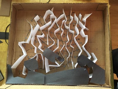

I used an old cardboard box and cut the back panel out. I then sketched the outline of the fireplace on the cardboard using the YouTube video as a guide to the position of the flames and the logs. I then punched holes in the cardboard in a random pattern that roughly corresponded to where most of the flames were in the video images. I then pushed the LEDs through the holes, bending the wires so that they fit (this is why you need LEDs on a flexible string with at least 4 cm of wire between each LED).
To create a flame-like effect, I used strips of white paper of equal width, glued to the cardboard panel with the LEDs in and added some black paper shapes to represent the logs. The images above show the front and back of the display panel after fitting the LEDs and the paper strips.
Finally, I covered the front of the panel with one sheet of white paper cut to size and taped it in place.

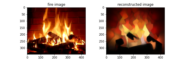

Step 5: Compute LED Intensities to Mimic the Real Fire Video
This is the hardest step. The goal is to find the LED colour intensity values (red, green, blue) that best match each frame from the real fire video.
Before starting this step, you will probably have to crop and scale the images from the smart phone so that the locations of the LEDs in that video, match the locations of the flames and the logs in the fire video you are trying to mimic. The way I did this, was to create composite images showing all the frames blended together and setting them side-by-side. Then I adjusted the size and scale of both until they looked right.
The simplest way to compute the colour intensity values for each video frame is to consider the effect of each LED separately. Starting with the red colour channel, the computer adjusts the brightness of the mask image until it minimizes the squared difference between the true image from the fire video and the adjusted mask image. To do this I used a numerical optimizer—the optimize.minimize function from the Scipy library. I constrained the adjustment factor to the range 0 to 1, so this ensures the colour intensity values are all between 0 and 64.
Then repeat the optimization procedure for each LED, for each colour (red, green, blue), and for each frame in the video you want to replicate. This can be a slow process, depending on the optimization algorithm you use and the speed of your computer. In my case it took 1.5 hours to calculate the LED intensities for 40 frames of video.
The image above shows the LED intensities calculated for an example fire video frame shown on the left.
