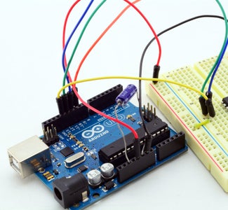

Programming the Chip:
  1. Before setting up your breadboard with parts, plug your Arduino into the USB port.
  2. Select the corresponding model from the dropdown menu -- mine is "Arduino Uno."
  3. From the examples menu, select a sketch called "Arduino as ISP". Upload that sketch to your Arduino.
  4. If it went successfully to your Arduino, place the 10uF capacitor between the GND and RESET female header slots on your Arduino.
  5. With your Arduino still connected via USB, set up your breadboard and Arduino configuration as per my images or from the images in the links above.
  6. Ensure your ATtiny85 is placed properly with the V+ and GND rails polarized, and the other wires connected to the Arduino's female header pins:
Arduino +5V ------> ATtiny Pin 8
Arduino Ground ------> ATtiny Pin 4
Arduino Pin 10 ------> ATtiny Pin 1
Arduino Pin 11 ------> ATtiny Pin 5
Arduino Pin 12 ------> ATtiny Pin 6
Arduino Pin 13 ------> ATtiny Pin 7
Now simply open your chosen mushroom sketch from my downloads links, choose the proper output from the Tools > Boards menu ("ATtiny85 @ 1MHz (internal oscillator; BOD disabled)") select "Upload Using Programmer", and wait until the sketch goes through. There might be two error messages about pagel files: these are to be expected, and if you just see these along with the "done" message, your sketch went through successfully. Remember, though: after uploading your sketch to the ATtiny, be sure to test it out on the breadboard by plugging in a speaker, LEDs, resistors, and a tactile button. If it works properly, it was a success, and you can remove the ATtiny and save it for when you build the circuit.
The three download links in this section contain your choice of sketches: the 1-up sound, the Super Mario World Overworld theme, or the Super Mario 3 airship victory music. All codes have essentially the same exact functions, such as blinking the LEDs in sync with the audio, only they're of course different songs -- and the red mushroom songs have some of their setup slightly adjusted to have different speeds and beats, and even some of the pitches adjusted. All codes will put the project in standby (power down) mode when not in use, and will be waken up immediately from tapping the tactile switch to replay the music/LEDs -- like a one-shot timer. Therefore, you can power this with as little as 3V in a coin cell, but I chose 6V to amplify the sound/light. If you'd like to change the music, you can do so by altering the notes and beat durations in the sketch. I have little or no knowledge of music, so I was able to successfully recreate the songs by downloading MIDI files from this website for Nintendo music, importing the MIDIs into Anvil Studio (freeware), and examining the individual notes/beats in the piano roll editor -- one note at a time. These mushroom sketches only allow for one tone to be played at a time, which means you can't have harmony nor chords. Most Mario songs have the tunes being played in multiple notes of harmony simultaneously, hence for my codes, I've used the middle notes. Both red mushroom songs unfortunately required several tracks of instruments and notes, thus I've reduced it to just the basic tunes.
Regarding my Mushroom sketch itself, it was an amalgamation of several sketches I've found online or in the Arduino IDE default library, only heavily modified to suit the needs for my code. The main sketch I've extracted my code from, however, was in this tutorial for making a musical Futurama Robot Santa statue by Psychic Origami -- in fact, I've even based the design of my Mushroom's internal circuit board off of his design as well. I've of course adjusted my circuits as well where applicable, and chosen some different variables.
Please note in regards to my Arduino melody notes: I've adjusted the note durations and note variables in each of the codes. If you look at the "notes.h" section, you'll see the beats assigned to variables: as the names suggest, BEAT is one standard note, HALF_BEAT is half a note, however QUARTER_BEATA is one quarter note, and QUARTER_BEAT is actually one eighth note -- the shortest note available. I changed these names while I was experimenting with notes, thus I never switched the name to "EIGHTH_BEAT" as it should properly be. That being said, you're certainly free to adjust the note durations and variables. I also think that I've slightly adjusted the Super Mario 3 victory music to be slightly slower than the Super Mario World Overworld theme.
