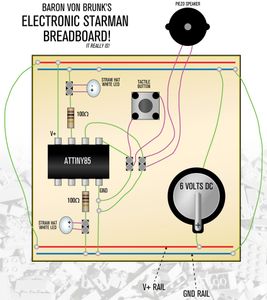

This section makes the assumption that you're familiar with soldering, as well as using component parts in a circuit. If you're having trouble creating circuits, please refer to this handy Instructable for beginning soldering. That being said, you're now ready to move on and build the circuit.
Refer to my breadboard diagram above. I chose not to make a Fritzing diagram, as it's difficult to convey the method of having the LEDs connected to header pins via wire, let alone how to convey the female header pins in general (after all, the Fritzing software's breadboard is basically just one huge series of female header pins, anyway). That being said, my breadboard diagram above is a hybrid design of a breadboard and a schematic, with everything simplified enough for amateurs, but detailed enough for experienced electronic builders. Like all electronics projects, always experiment with a breadboard first, just to see if your circuit will even work to begin with. If you're satisfied with your breadboard, you can map out where to place components on the circuit board. Do a dry run to map out where the parts will be placed with the best space-saving options; refer to my photo of a completed circuit with batteries. Before soldering, place the 8-pin socket on the board first, then put on the battery holder, followed by the resistors (corresponding to the respective ATtiny85 pins), finally the female header pins. If your dry run circuit resembles mine, then feel free to use a pencil to mark the locations to permanently solder the parts, then begin heating up your iron!
Start with soldering down the two most viral parts: the 8-pin socket for the ATtiny85, and the battery holder. You don't have to solder each pin of the 8-pin socket, just the ones vital to the circuit (see my illustration: for instance, the first two bottom row pins on the ATtiny serve no use for this project). Attach the two resistors, however, you can save time by omitting them and simply attaching the resistor to the wire for the LED; it's your choice. I personally placed the resistors in permanently connected to the pins of the 8-pin socket, which then leads to a slot in the female header pins. For the first LED, cut a section of two female header pins: this will be used as the terminal for the first LED. Have one pin of the header pins connected to the resistor (+), and the other will lead to the ground terminal (-). Your LED's respective pins will then be placed in these slots: the positive pin in the slot connected to the resistor, and the negative pin in the slot that goes to the ground terminal. Cut six female header pins: this row of six slots will be used for the second LED, the speaker, and the switch. Like the previous row of header pins, make sure the ones on the left of the row begin with where the resistor is connected, as this will be the positive slot for your LED, with header pin 2 leading to the ground terminal. Header pin 3 will be the slot for the red wire for your speaker, and header pin 4 will hold the ground wire for your speaker (connect header pin 3 to the ATtiny, and header pin 4 goes to ground). Header pin 5 will be connected to the ATtiny for the switch, and likewise header pin 6 goes to ground -- use these final two slots for eventually keeping the two wires for the switch. Once everything is properly soldered down, you can then move forward by attaching the removable components to test: insert the two batteries, the ATtiny85, the switch, the speakers, and the two LEDs. Tap the button to see if everything works, and if it's a success, remove the speakers, LEDs, and switch (but keep the batteries and ATtiny85 inserted), trim off the excess circuit board, and place the completed circuit into the back of your Starman!
For the LEDs, I've soldered on each pin about an inch of thin insulated wire. Also, if your wires are too thin, go ahead and solder a tiny piece of slightly-thicker tin bus wire to the ends of the LED's wires, so that they stay snug in the female header pins. If there's an excess of wire from the speaker, then either trim them down or wrap it around the circuit when placing it into the Starman. Cut about 3 inches of thin insulated wire and solder then to the tactile pushbutton (diagonally -- refer to my photo). The button and its wires will go on last, as it requires further assembly of the LEGO portion before being sealed off.
Common electrical problem: the ATtiny has a primary ground pin (pin 4), but pin 3 can act as a ground pin as well, yet pin 3 is reserved for the first LED. Since the first LED on pin 3 is grounded to the battery's ground terminal, this completes the whole circuit, but since the ATtiny is only partially grounded, it's as if your circuit is in a series instead of being in parallel, hence the LEDs will be dull and the sound is quiet -- making it seem as if your batteries are dying. In addition to pin 3's LED being properly grounded, always ensure the ATtiny85's pin 4 is grounded as well -- this makes the circuit truly complete, and the sound/lights function as intended. In other words, the ATtiny's 8th pin goes to positive, the 4th pin goes to negative, and the other pins connect to their respective components (which ultimately lead to ground as well). When I made the first circuit, I forgot to solder pin 4 to ground, thus my circuit functioned -- but rather dull and quiet, which led my initially to believe either the batteries were duds or that I improperly made the connections.
