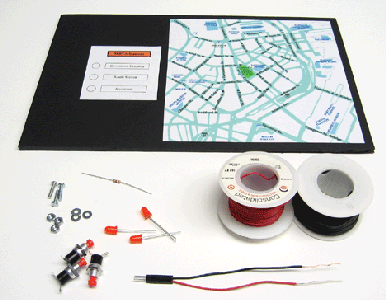

Collecting Your Components
In order to complete the electronic map project, you will need the following components (shown in Figure):
Part Quantity Description
A 1 Battery pack
B 3-15 LEDs (assorted colors)
C 3-15 Button switches
D 1 Foam board (12-inch by 12-inch piece)
E 8-12 390-Ohm resistor
F 3 Machine screws (1/2-inch, 4-40)
G 3 Machine screw nuts (1/2-inch, 4-40)
H 3 Washers
I 2 Spools of wire (1 black and 1 red)
J 1 Tape

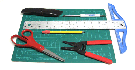

Step 3: Tools
You will also need the following tools, shown in Figure:
Tool Quantity Description
A 1 Utility knife
B 1 Cutting mat
C 1 T square
D 1 Wire stripper
E 1 Scissors
F 1 Screwdriver
G 1 Sharpened Pencil

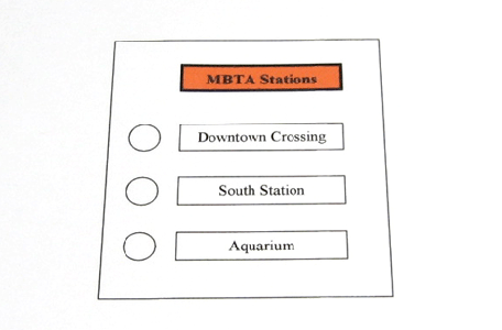

Step 4: Printing Out the Images
You can use any image you want for your map. Road maps and satellite images work well, but you could also use a building floor plan, a seating chart from a sports arena or theater, or any other appropriately sized image with specific locations you want to highlight. A map of downtown Boston, shown in Figure, is used in the project illustrations. A printable version of this map is available as pdfs below.
Once you have printed out your map, you will also need a set of three or more button labels, identifying specific locations on your map image. The labels used with the Boston map are shown in Figure, and a printable version is available as pdf below.

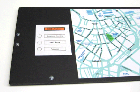

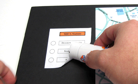

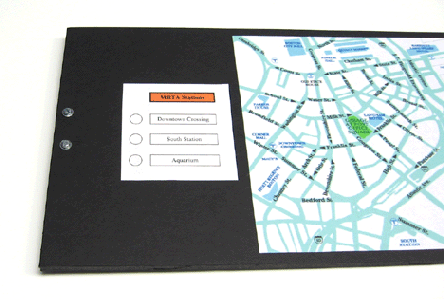

Step 6: Applying the Map Image and Button Labels
Glue from a glue stick is used to affix the map image and button labels to the map base.
1. Glue the map image to one side of your map base, leaving room for the button labels, as shown in Figure.
2. Glue the button labels next to the map image as shown in Figure.
*Note: I used a glue stick, as opposed to spray adhesive, for safety reasons. Not all classrooms are properly ventilated.

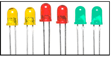

Step 8: About LEDs
Light emitting diodes (LEDs) are like tiny light bulbs that emit light when electricity passes through them. The figure below shows yellow, red, and green LEDs.

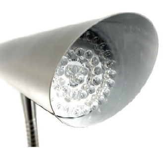

Because LEDs require very little electricity, and last for thousands of hours, they are becoming increasingly common in electronic devices and other applications. Your computer keyboard probably has a few LEDs to indicate when the Caps Lock or Num Lock keys have been pressed. Grouped together, LEDs can produce enough light to be used as a source of household illumination, as in the lamp shown in figure below.
Every LED has a specific polarity, meaning one of its two pins must connect to the power side of the circuit and the other pin must connect to the ground side. A tiny flat segment on the round rim of the LED's circular base marks the ground pin. The power pin is typically longer than the ground pin, but this is an unreliable indicator, since the pins may be trimmed during installation. Figure below shows these distinguishing features.

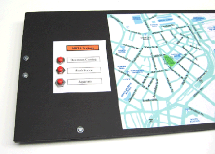

Step 10: Adding Terminal Screws to the Board
Three machine screws provide points of connection, or terminals, for the map's electronic components. Two of these screws should be positioned to the left of the button labels, and one should be placed directly beneath the button labels.
1. Using a screwdriver, puncture the foam board at the location of each of the three terminal screws.
2. Add the three machine screws, securing each with a washer on top and a nut on the bottom, as shown in Figure.
Step 11: Installing the Button Switches
The button switches should be positioned next to each of the locations in your map labels.
1. Using a screwdriver or a pencil, puncture the foam board at the location of each switch, as shown in Figure.
2. Add the switches, securing each with a nut on the top, as shown in Figure. (NOTE: You may need to compress the foam board slightly to thread the nuts securely onto the button switches.)

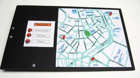

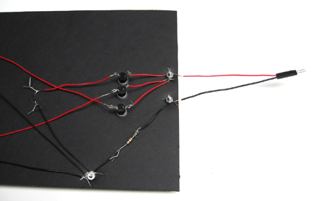

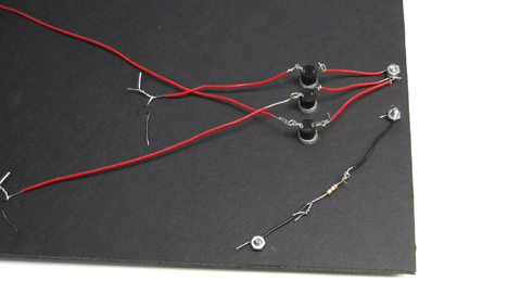

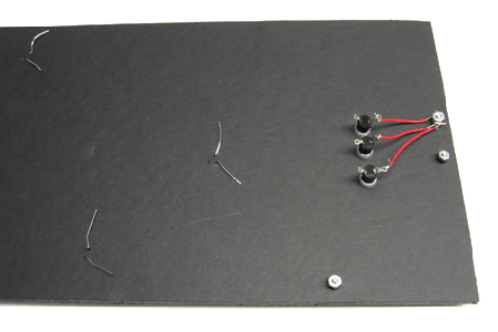

Step 13: Making the Electrical Connections
With your buttons, LEDs, and terminals installed, you are ready to connect these components on the back of the board.
1. Using short lengths of red wire, connect one of the two terminals next to the map labels to each of the buttons, as shown in Figure below. This will be the power terminal.
2. With longer lengths of red wire, connect the open side of each button to the power pin of the appropriate LED, as shown in Figure. (NOTE: Be sure to match buttons to LEDs correctly! You may want to label the buttons and LEDs on the back.)
3. Using two short lengths of black wire and a resistor, connect the two open terminals, as shown in Figure. These will be your ground terminals.
4. With longer lengths of black wire, connect the ground pins of the LEDs to the terminal screw beneath the map labels, as shown in Figure.

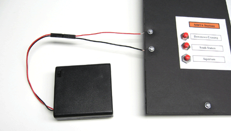

5. Connect the red and black battery lead extensions to the board, as shown in Figure.
6. Finally, connect the battery pack to the battery lead extensions, as shown in Figure.

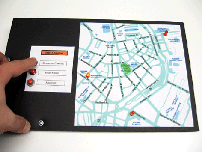

Step 14: Using Your Map
Turn on the battery pack, plug in the jump wire cables, and test your electronic map!
