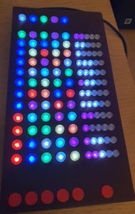

Introduction: Electronic MasterMind Game
“A battle of wits and logic between two players. Break the secret code.”
This is an electronic version of the classic 70’s Super Master Mind board game. The object is to guess the code that has been selected by the computer in as few moves as possible using clues given at each turn.

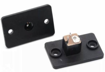

Female Socket barrel jack power connector 5.5x2.1mm
Short wire Jack plug connector male 5.5mm x 2.1mm

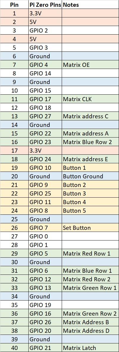

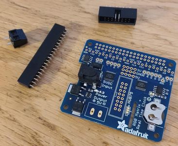

Step 2: Matrix Hat
There is also a Matrix bonnet which is a bit cheaper, but was not available while I was making this.
Solder the header and connectors as per the hat assembly instructions:
https://learn.adafruit.com/adafruit-rgb-matrix-plus-real-time-clock-hat-for-raspberry-pi/assembly
I cut a thin plastic sheet to insulate the bottom of the matrix from the other components, with a cutout for the power and data cables but this is optional
Connect the hat, matrix power connectors, and data ribbon cable then power up the Pi for the next section.

Step 4: Python Program and Auto Run
Create a folder in the home directory of the Pi called mastermind and save the mm-main-game.py  and samplebase.py files there. Make sure the program runs by issuing the following command:
Sudo ./mm-main-game.py -r 16 -b 100
(Or you might need to specify the python3 interpreter)
Sudo /usr/bin/python3 /home/pi/mastermind/mm-main-game.py -r 16 -b 100
SUDO is needed to run the program as the matrix driver needs this to function correctly. You can run without, but you might get flickers or glitches.
The –r specifies the rows and the –b is the brightness (100 is max)
CODE BELOW. I wasnt able to attach this as a file, not sure why.

Step 5: Button Connections
Cut 4 Pin and 3 Pin sections of a header and solder them to the HAT on Pins 20,22,24 and 26 (outer side); and Pins 19,21 and 23 (Inner side) – see photo: (please forgive my horrible soldering skills)
Also see the pinout of all of the connections.

Step 7: Button Wiring
Once you are happy, superglue the buttons onto the bracket – making sure you get the alignment just right through the top cover.
Due to the constraints of the size of the matrix and the print bed size, there is very little room for the buttons and the wiring; so I used stiff wire to connect up all the ground pins of the buttons on one side, and soldered short lengths to the other side so I could connect the dupont wires underneath.
Taking careful note of which wire is which, feed the wires through the holes and carefully seat the buttons down into the case.
Connect the wires to the pins soldered earlier on to the board, making sure you get the correct pin connected to the board.
Pin Pi Pins Notes
19 GPIO 10 Button 1
20 Ground Button Ground
21 GPIO 9 Button 2
22 GPIO 25 Button 3
23 GPIO 11 Button 4
24 GPIO 8 Button 5
26 GPIO 7 Set Button
Step 8: Power Connector
Solder the short male barrel jack connector to the external barrel jack connector. (both of these parts were bought on ebay very cheaply)
Then connect it to the internal power connector on the Matrix hat board. This could also be achieved with a direct soldered connection wire, but I found it easier this way.

Step 10: Playing the Game!
Power on the game by connecting the 5v power supply.
The system will take about 1 minute to boot, and once ready, the front panel will pulse all the lights to indicate it is ready to go.
A copy of the original games instructions is attached.
Press any button and the game will pick a random code and hide the result.
The game will then indicate the first row and light up the first set of code lights.
Press a corresponding button to change the colour of the code, there are eight colours; Red, Blue, Green, White, Orange, Yellow, Aqua, & Purple. The buttons will cycle through the colours on each press.
Once you are happy press the right button to enter your guess, the game will the score you as follows:
A purple light indicates there is a code of the correct colour and location – the position of the score light does NOT indicate that this is the correct location!
A White light indicates there is a code of the correct colour but in the wrong location – again the position of the score light does NOT indicate which colour is correct!
Once the score is indicated the game will light up the next row to allow you to modify you guess and try again.
If you guess correct or you run out of guesses the secret code will be revealed on the top row.
Good luck Master Mind!
