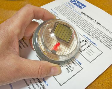

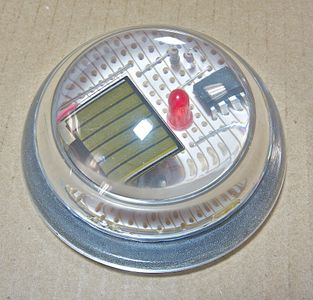

Introduction: Electronic Paperweight
Imagine a paperweight that not only holds piles of paper in place, but perpetually blinks !

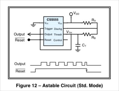

Step 3: Astable Operation
The basic circuit used here is the standard 555 astable setup. At the start of an ongoing cycle, the timing capacitor CT starts charging up through resistors RA and RB; the discharge pin is open and the output pin is high (i.e. at the supply voltage VDD). When the rising capacitor voltage reaches the upper trip point, which is 2/3 of the supply voltage VDD , the output and discharge pins go low, i.e. are connected to ground or 0V. The capacitor voltage then drops via resistor RB until the lower trip voltage, 1/3VDD, is reached which brings the trigger pin to the lower trip voltage and that causes the output pin to go high again and the discharge pin to disconnect. The cycle then repeats itself as before. Note that the reset pin must be connected high for operation; setting this pin low stops the timer and the output pin goes low.

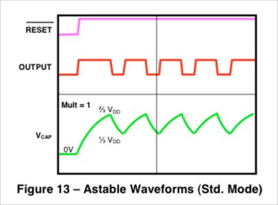

Step 4: Voltage Waveforms
The diagram shows how the voltage cycles at the output pin and the timing capacitor. After the initial energizing of the circuit, steady state operation is established and the capacitor voltage cycles between 1/3 and 2/3 of the supply voltage. On its upward rise, the voltage at the output pin is high, VDD; on its downward discharge, the output voltage is low, 0V.
The lengths of the on and off periods are determined by the values of RA, RB, and CT. The on time is inherently longer than off because the resistance for charging the capacitor is RA+RB, whereas the discharge resistance is just RB. In order to achieve an on time less than the off time, we connect the LED with its cathode to the output pin and its anode - through a suitable resistor - to the supply voltage. In this way, the LED goes on when the output is low, and is off when the output pin is high. This gives a duty cycle of RB/(RA+2RB), which is the ratio of time the output pin is low to the total time of a cycle. The timing capacitor contributes to the complete cycle time, or period, according to the following expression: 0.695(RA+2RB)CT.

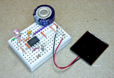

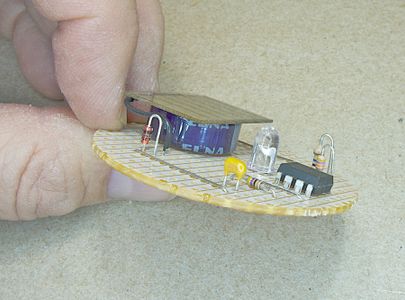

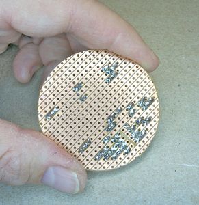

Step 6: Construction Details
A Google search will reveal a host of suppliers of phenolic stripboard. The CSS555 Timer IC is available from Jameco . Be sure to find a supercapacitor of 1 Farad or better, with a voltage rating of at least 5V.

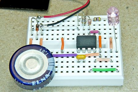

Step 7: Breadboard First
Once the electronic components have been gathered, breadboard them together to make sure everything will work to your satisfaction. It is not a pleasant task to fix a circuit once it has been soldered together. Let the breadboard setup run for a week or two in the location and under the lighting conditions in which it will eventually reside.

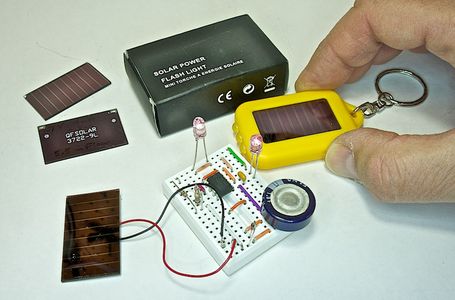

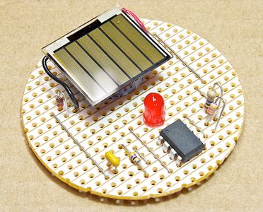

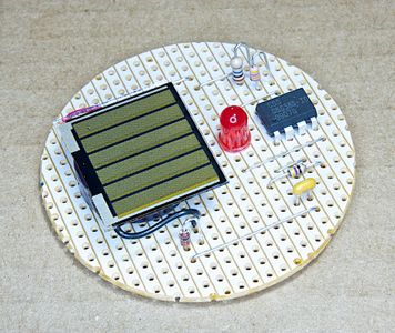

Step 8: Solar Cells
The solar cell to use should be the thin film on glass type because these have good voltage under indirect or ordinary room lighting - even fluorescent. They are not as easy to find as the silicon crystal type. Calculator batteries are the right kind, but their output is too low in voltage and current - calculators these days do not need much power ! Imagesco.com have some very nice indoor type cells, but they are larger than would fit inside a paperweight of the size used here. Well...a larger paperweight with several blinking lights would be neat...or...a set of blinking book ends ! Smaller indoor type cells have been available at Deal Extreme - one of these is shown in the photo. A cell with a nice strong output for this application can be taken out of a solar keychain flashlight like the one shown in the last two photos. It is a bit larger than the one used in the prototype, but could maybe be squeezed into a small paperweight. You could even use the rechargeable battery from the flashlight instead of the supercapacitor, but the battery will only stand up to a thousand or so recharge cycles, whereas the capacitor has virtually unlimited life. The output voltage of the solar cell for the lighting conditions to which it will be exposed should not exceed the 6V absolute max. rating of the CSS555 chip or the max. voltage rating of the storage capacitor which is typically 5.5V; the blocking diode will reduce the peak voltage of the cell somewhat. You could insert anther diode or two in series to drop the voltage of the cell if necessary. All this should be sorted out during the breadboard trials.
