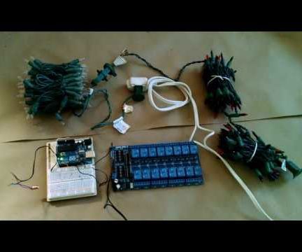

You will need the arduino, relay, 12V power brick, igniters, and battery
DATA
Ok so what you will need to do is connect pins 0-13 on the Arduino UNO to pins 1-14 on the relay board, this is to send the signals from the Arduino to the relays, we need relays because the arduino itself is unable to power the firework igniters, and if it can, it will fry it.
POWER
Ok if you dident know you can power the arduino off its 5V pin, but there won't be any protection, so the way I did power is as follows
Take the power adapter and chop off the end, then strip the wires. The positive wire is almost always the one with the white line or text on it, and I personally like to tie a knot in it. Now take the wires and attach them to the relay boards power screw terminals. Now to deliver power to the arduino I used the 5V output of the relay board and connected it to the arduino's 5V pin and the ground on the relay board to ground on the arduino
That takes care of the arduino connections, next the
IGNITERS
This is where the lawnmower battery comes in, it will be used through the relay to launch the igniters, you will need to connect the positive pin of the battery to one side of each relay, now connect one wire of each igniter (Signal wire) to the other side of the relay. At this point you will need to take the other wire of each igniter and attach them all together then connect all of them to the battery's negative terminal, but make sure that you can easily connect/disconnect it as you will need it unpluged to test it without launching everything
one question that I imagine people would have is "why can't I just use the 12V off the battery?" And the truth is You Can, but I recommend using a 12V power supply as it will produce a much better and consistent voltage. A lawnmower battery can put out anywhere between 10.5-14V on a "full" charge. So unless you are in the middle of nowhere I would recommend using a power brick.
