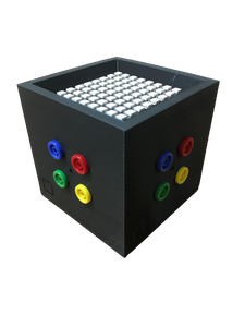

This is the Technological Tesseract--an electronic puzzle box. The goal of this puzzle is to connect three wires to the jacks in the correct configuration to make the LED matrix light up in a fun way. There are four different colored jacks (red, blue, green, and yellow) on each face, and a shape on each face to serve as an indicator (triangle, square, pentagon, and hexagon). To determine where to plug in the wires, you must solve the a series of puzzles.
The motivation behind this puzzle box was to tell my parents and my in-laws that my wife and I were pregnant. After we started working on it, we saw the puzzle box from Glass Onion and mentioned to our families that it would be fun to make something like that. It was a great marketing tool to keep them from suspecting anything. After sending the finished product off to each of them, they were enthralled and had a blast solving it. They didn't suspect a thing when the words, "WE'RE PREGNANT!!!" rolled across the LED Matrix. We got some priceless reactions and wanted to share our process so that others can hopefully have some fun moments with the design.

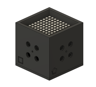

There are 4 major pieces that need to be printed--the case, the battery container, the protoboard platform, and the QR code. If you print non-stop, it will likely take 1-2 days to print everything. Make sure to print the QR code separately since it requires a filament change. Below I've laid out the process depending on whether or not you have a 3D printer.

  1. Download the STL files here for the puzzle cube
  2. Upload them to your favorite slicer (e.g., Cura, Creality Slicer, Simplify3D, etc.)
  3. Print away

Step 15: Celebrate! You Did It!
I hope you had tons of fun reading or doing this project! Thanks!
