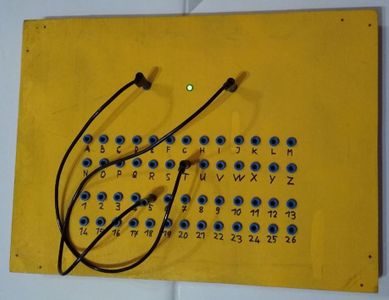

Since we have 26 letters and 26 numbers I went for two lines of 13 respectively. The distance between second and third line is slightly larger to separate letters and numbers. In the top middle position the LED will deliver judgement over the answers. To it's left and right there are sockets for the fixed positions of the banana leads.

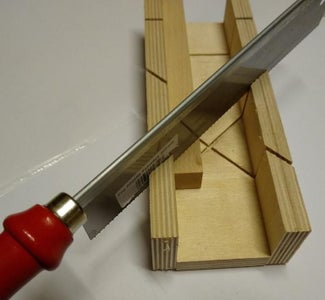

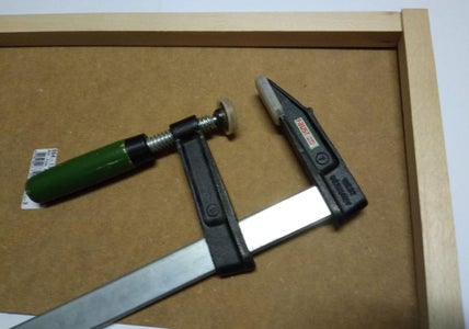

For the frame I used 20x20 mm square wood. It's kind of a tight fit with the sockets so 25x25 mm might have been a more reasonable choice in combination with the sockets. Saw the the wood to the fitting length and fix it to the front panel with some wood glue and/or nails. I used both. Way back I made some plain 90° cuts (or more like 85° cuts) but with a quite primitive fixture you could make 45° mitre cuts to make it look even nicer. Or maybe you own some fancy circular saw.
If you want to paint your game, now is the time to do it. You don't want to paint the sockets and the LED as well. I always do this in the backyard to get enough fresh air and use a big flattened cardboard box as underlay so I don't end up with coloured turf.

A game painted in green and featuring yellow and blue buttons could look like this. Label all sockets or buttons with there respective letter or number in a readable way. I just used a black marker. If you use sockets, put a end of one banana lead to the socket left to the LED and a end of the other lead to the socket on the right. Now you can check your combinations. If something went wrong you have to fix it
