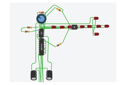

Step 1: Let's Design the Circuit
We can make this sculpture circuit without using the tinkercad but using the tinkercad has many advantages. First, we can verify whether the circuit will work or not without buying or using actual components. Second, we can arrange the components in any shape or pattern. So you can see the above images, one is the circuit with all components and another is the same circuit with same components but the shape is different. Here I have used potentiometer as a head of person, two IC's for body, capacitors for leg, resistors for hand and neck, resistors and BC547 transistor as a bow and LED's for arrow. IF you want to try simple circuit you can make a smiley using 555 timer IC and two LEDs. There are so many cool circuits you can build with 55 timer IC.
Working of the Circuit:
In the 555 Oscillator circuit above, pin 2 and pin 6 are connected together allowing the circuit to re-trigger itself on each and every cycle allowing it to operate as a free running oscillator. During each cycle capacitor, C charges up through both timing resistors, R1 and R2 but discharges itself only through resistor, R2 as the other side of R2 is connected to the discharge terminal, pin 7.
Then the capacitor charges up to 2/3Vcc (the upper comparator limit) which is determined by the 0.693(R1+R2)C combination and discharges itself down to 1/3Vcc (the lower comparator limit) determined by the 0.693(R2*C) combination. This results in an output waveform whose voltage level is approximately equal to Vcc – 1.5V and whose output “ON” and “OFF” time periods are determined by the capacitor and resistors combinations.
Astable 555 oscillator Charge and Discharge Times:
t1 = 0.693 * (R1 + R2) * C
t2 = 0.693 * R1 * C
where, R is in Ohms and C in Farads.
In the above circuit we are using R1 = 1K and R2 = 10K (potentiometer) and C = 10uf. Because of potentiometer we can change the duty cycle of the circuit and can get the fast and slow blinking effect on LED's.
On tinkercad you can try different combinations of R1 and R2 and see the effect.

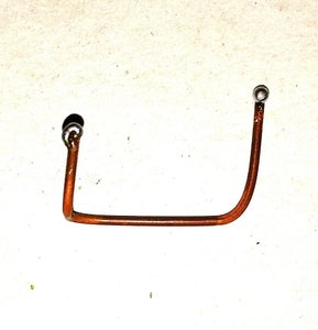

Now the real fun begins. Whether you are a pro in soldering or not this step is going to test your patience. for last 1 year I was working mostly on software projects. I tried electronic project almost after a year. When I started soldering, I realized that I did not have good soldering iron but I am good at soldering so somehow I managed to do satisfactory work. In the next version I will improve soldering and wire routing. So before starting the soldering make sure you have all the tools and all are in working conditions.
I have soldered the components without using any clamp or third hand. To hold some components I used double sided tape. Even to bend and cut the copper wire I used only nose plier and cutter, nothing else. I got the good outcome at the end but I could have improved the result. So I will share some tips to get the best result.
Tips to get the best outcome:
  • Use double sided tape or third hand to hold the components.
  • Use brass rods of 1mm if possible because these rods are straight unlike the copper wire.
  • Take print copy of tinkercad circuit in proper scale which will help you to measure the wire length between two components and cut the wire of that length.
  • Make the bends wherever needed using nose pliers. You can also use 3d printed parts to bend the wire at particular angle. I am going to make some more free-form circuits so I will design some parts to make wire bending easy and perfect and I will update here.
  • Make sure wires are not touching to each other. keep distance of 2mm between each wire and rout your wires according to that.
  • Use multimeter to debug the circuit.
