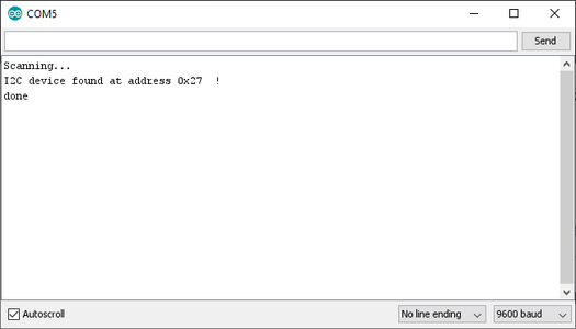

Step 2: Get the Display's Address
To get the display's address, upload this sketch to ESP.
https://playground.arduino.cc/Main/I2cScanner/
Then open the Serial Monitor, and set the baud rate to 9600. If you've done everything right, you should see the display's address.

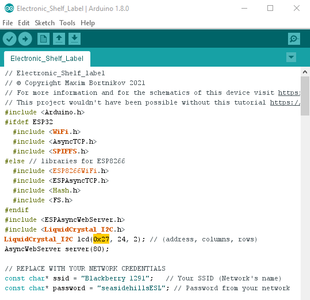

Step 4: Adjust Three Values
Firstly, replace the display's address (highlighted by yellow) with the one you got from the step 2.
Secondly, replace Blackberry 1291 with your SSID.
Thirdly, replace seasidehillsESL with your password.
Step 5: Flash the ESP
