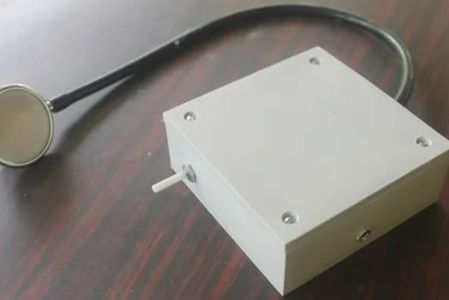

Introduction: Electronic Stethescope

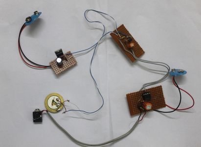

This is easiest way to create an electronic stethescope

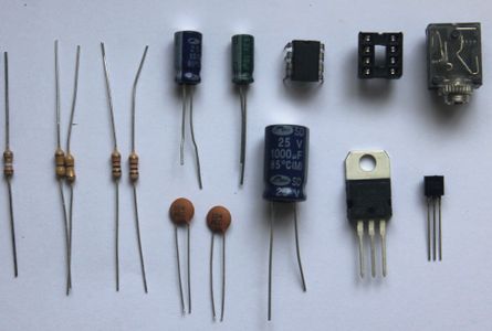

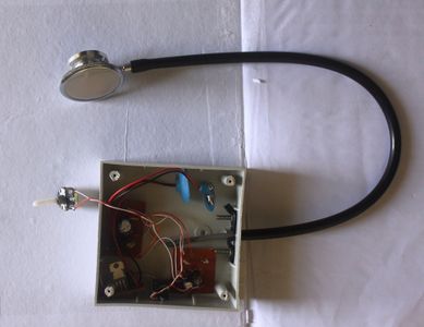

Step 1: Components List
1. 1 x BC547
2. 1 x LM7805 voltage regulator
3. 1 x LM386
4. 2 x .1uf ceramic capacitor (104)
5 1 x 100uf 25v electrolytic capacitor
6 1 x 1000uf 25v electrolytic capacitor
7 1 x 10uf 25v electrolytic capacitor
8 2 x 470K resistor
9 1 x 3.9 ohm resistor
10 2 x 1k resistor
11 1 x 3.5mm Headphone jack
12 1 x 8 pin IC socket

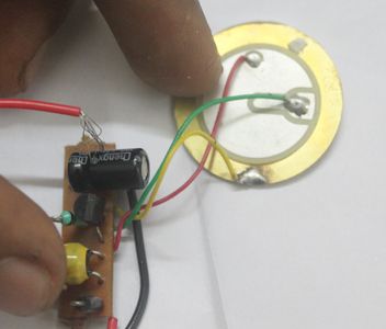

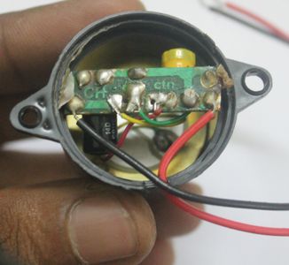

Step 3: Transducer
piezo transducer I used here is found from a bike indicator buzzer... open it up an u can find a disc shaped buzzer as shown in the picture. we just need the red and yellow wire, where red is positive and yellow is negative. green is feedback but we don't use that wire just clip it off

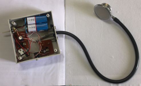

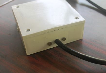

Step 4: Inserting the Piezo Into a Cheap Stethescope
Step 5: Conclusion
It will work exactly as expected and can be used for projects
