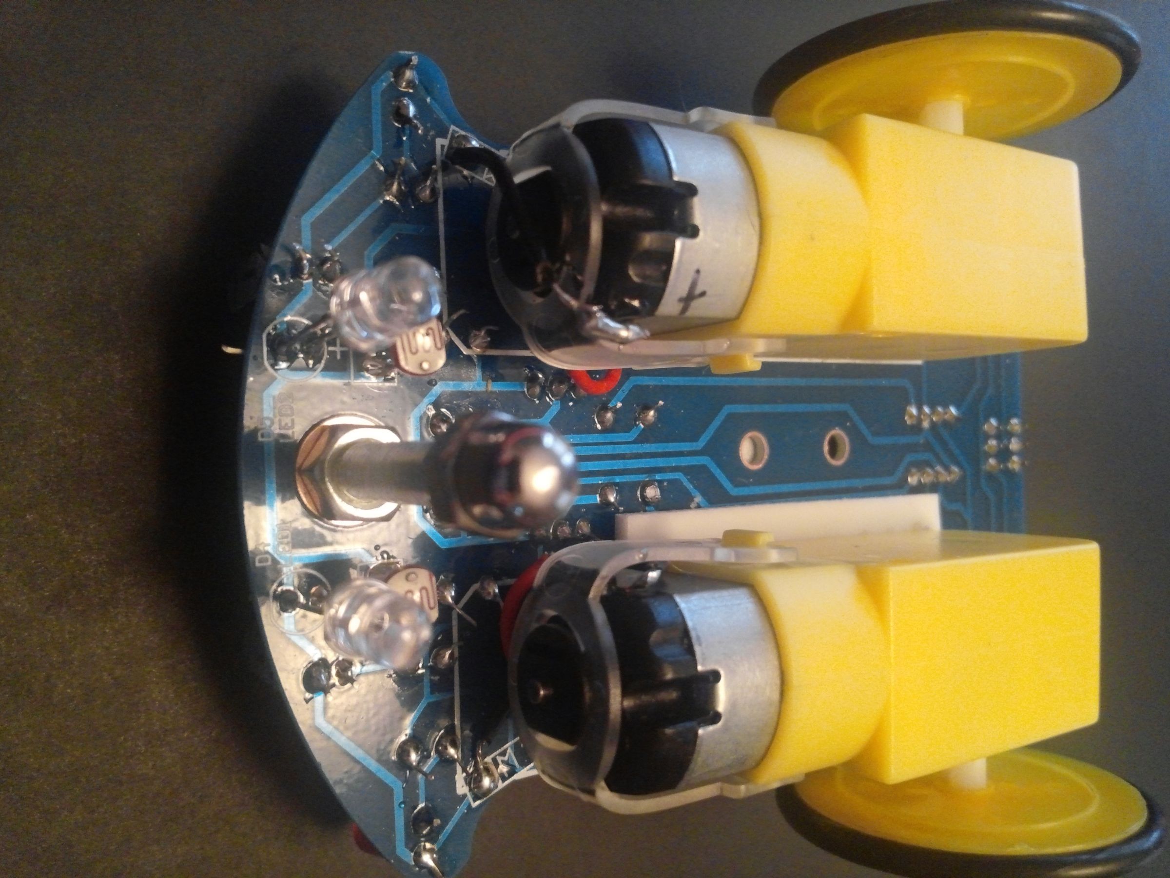

Step 3: Solder
Soldering was what took me the longest just because I'm terrible at it. Protip: make doubly sure that you're plugged into the correct spaces on the board before you make it permanent. The kit is very good about having the shape etched so you can match it up. If polarity is a factor, that will be marked as well.
Here is a cheatsheet:
R - Resistor (12 total)
R1GR - Light Dependent Resistor (LDR) or Photodiode (2) Learn here
C - Capacitor (2 black battery shaped)
Q - Transistor (2 half moon shaped)
D - Diode (D1 D2 Red LEDs) (D4 D5 clear, light up along path)
IC - Integrated Circuit (BRAAAIIINNNSS - Zombie)
Sequence your soldering from low to high, the first with resistors, then onto the taller components. The instructions that I read afterwards say to place the photodiodes at 5mm height, but I was tired and soldered them at a height much closer to the board. This is what determines how it will track along the track (motor on or motor off) so I would assume they ought to be flush with LEDs, but mine works just fine.
You can connect the on/off switch and integrated circuit now as well.
After the solder cools, clip the excess but do so in a way where they are shot across the room like projectile needles. Do not point it at your eye whilst clipping. Target ought not be your own eyes unless you are sick of seeing.

Step 4: Wiring the Motors
Don't stick the motors down yet!
If you are getting antsy, this is where you can stick down the battery compartment and run the wiring through the board hole.
To test direction*, I put in batteries and connected the wires from the battery directly to the motor leads to see which direction it turned. Now you can mark which post needs to be positive, and which needs to be negative. Make sure to place the motor in the orientation it will be mounted in order to make sure it is turning in the correct direction.
Once you are sufficiently satisfied, take out your batteries and solder your connections before sticking down your motor.
NOTE: The positive sharpie mark on the motor 2 is wrong. I zigged when I should have zagged.
The red wire is connected to the 3V positive power supply. There is plenty of extra wire, so the excess can be used for mounting the motors, clip and strip to your liking. I tried to stay consistent with the coloring of my wires, but you can use the extra included wire to make your connections.
If you haven't done so already, stick down those motors, check that everything is connected and get ready to have your mind blown.

If you've done everything correctly, when you put in your batteries, you can push the "on" button, place the car on the track and marvel at the magnificence of autonomous automobilia!
If it doesn't work, check your solder connections. I had a negative lead that was not making a good connection with the board therefore was leaving the circuit open. Once I resoldered that connection (removing the batteries prior of course), it came to life like Frankenstein's monster!
