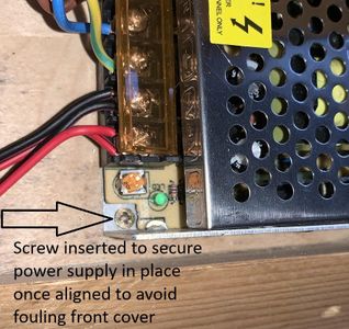

Step 4: Fit PSU
Fit a screw into place which allows the PSU to be slid into place and secured. It may be difficult to access this screw after the PSU is in place. Slide the PSU into place and secure with another screw, having first ensured that the PSU case does not foul the front panel of the organiser when it is refitted.
