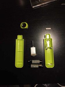

Step 1: Step1: Open It Gently.
The reason why I say we should open it gently is because we want to keep all the sections safely survive and obviously to see where connect to where.
The tool for opening this eraser is only hand because it is designed to completely open to change the battery.
After you open it, there should be:
1, front case.
2, back case.
3, top case.
4, moto.
5, batteries.
6,battery connector.

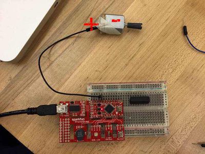

Step 2: Step2: Connect It to Protosnap.
This step is actually a test step.
Connect your motor to VCC and GND to see if the motor works.
If it works, you can start your next step.
Tools:
1, 2 Jumpers.
2, protosnap .
3, breadboard.
4, tape
5, micro USB
6, a computer
protosnap connect to breadboard.
VCC connect to + terminal on motor
GND connect to - terminal on motor(the metal case)
tape them.
to see if the motor will turn.

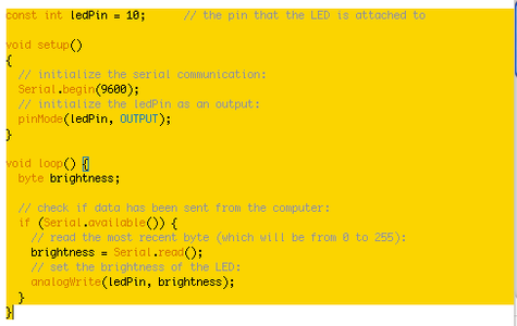

Step 5: Step4: Upload Arduino.
Get the code here.
copy and paste to arduino, then upload it by click upload.

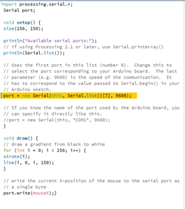

Step 6: Step5: Processing
copy followed code to processing.
According to your serial port to choose port from /* port = new Serial(this, Serial.list()[0], 9600); */
the no. of the port to the number that replace [0].
Get your code here.

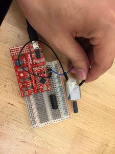

Step 7: Step6: Run.
When it successfully runs.
You will see the window.
Put your mouse on white, the motor turns on.
put your mouse on black, the motor turns off.
