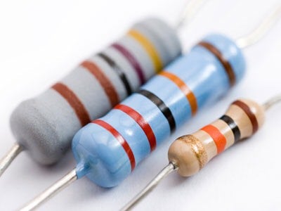

A resistor adds resistance to the circuit therefore slowing down the flow of the electrons (current). It's schematic symbol is a "zig-zag" type symbol. A resistor consists of two legs and is considered a passive component.
The different colors on the resistor tell the resistance (in ohms) and the tolerance (in %).
They also have different power ratings measured in (watts).

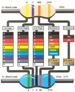

To read the resistor you read it from left to right, resistors have four bands. Usually the tolerance reading has a bigger gap from the other 3 the third band is the multiplier and the first two are the first numbers. E.g. If the resistor is Brown,Black,Brown and Gold the resistor is 100 ohms @5% tolerance.
Any resistor with a resistance of 1000 ohms and greater usually is abbreviated with the letter "K". For example 1000 ohms = 1K.
And resistors with a resistance over a million are abbreviated with the letter "M". For example 1.000.000 ohms = 1M.

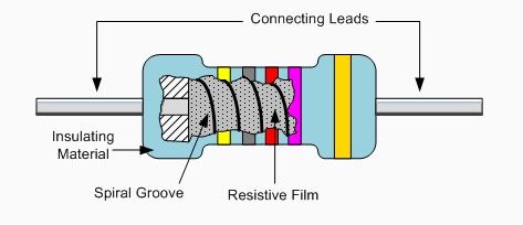

A resistor consists of a resistive film and a spiral groove.

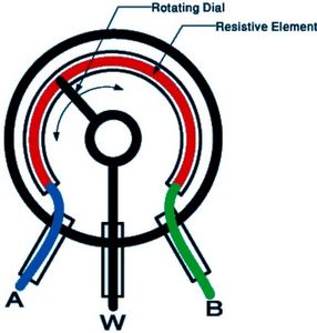

Step 2: Variable Resistor (Potentiometer)
A variable resistor is a potentiometer with only two connecting wires instead of three. However, although the actual component is the same, it does a very different job. The pot allows us to control the potential passed through a circuit.
