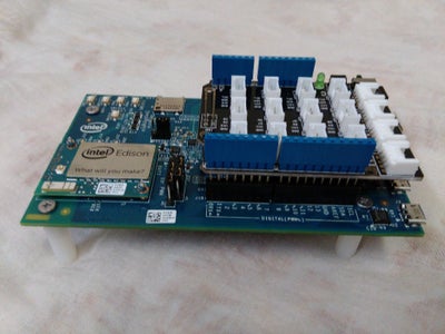

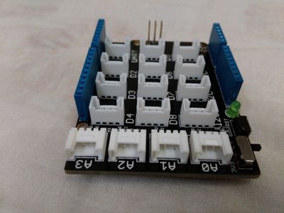

Step 1: Connect the Relay Board
Connect the relay board (if you choose to use it) on the Intel Edison board.
This really simplifies the connection of sensors and other modules.

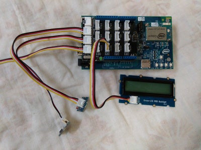

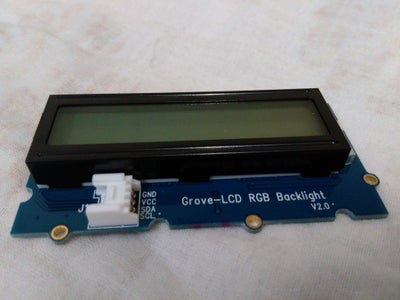

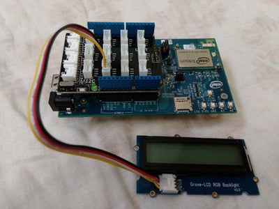

Step 2: Connect the LCD Shield
Connect the LCD Shield using a jumper wire.
Alternatively, you could connect the LCD to the corresponding pins (Vcc, Ground, SDA and SCL) directly.

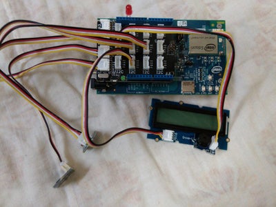

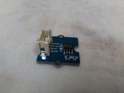

Step 3: Connect the Sensors
Connect the sensors using jumper wires.
In this code, I connect -
- Gas sensor at A0
- Temp Sensor at A1
- LDR at A2
Step 4: Connect the Outputs
The intended use of the project involves using a relay module, but for demonstration purposes, I have used an LED, and two fans.
For Connecting the relay module, follow these instructions.
Here I connect buzzer at pin 8, LED at 13, and the fans at 6 and 7 (For fan and heater). I have used to jumper wires and base shield to connect easily, but the same can be done using normal wires.

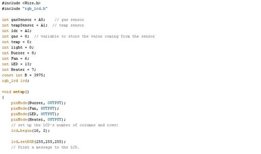

Step 5: Upload the Code
Connect the Intel Edison to the computer using two Micro-USB cables.
Use this code and upload it to the board. It is an Arduino code, so you'll need to use Arduino IDE. Consult this guide for more information.
The code is really simple to understand and you can make your own if you like.

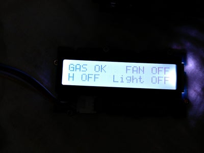

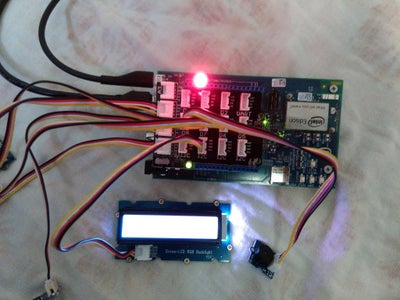

Step 6: Verify
The output should look similar to this.
You may need to calibrate the threshold values in the code to get correct results as each unit of the sensor is a little bit different.
Try covering the LDR to check the light and adjust the threshold values. You may use a portable lighter to check the gas sensor and temperature sensor and calibrate the values too.
