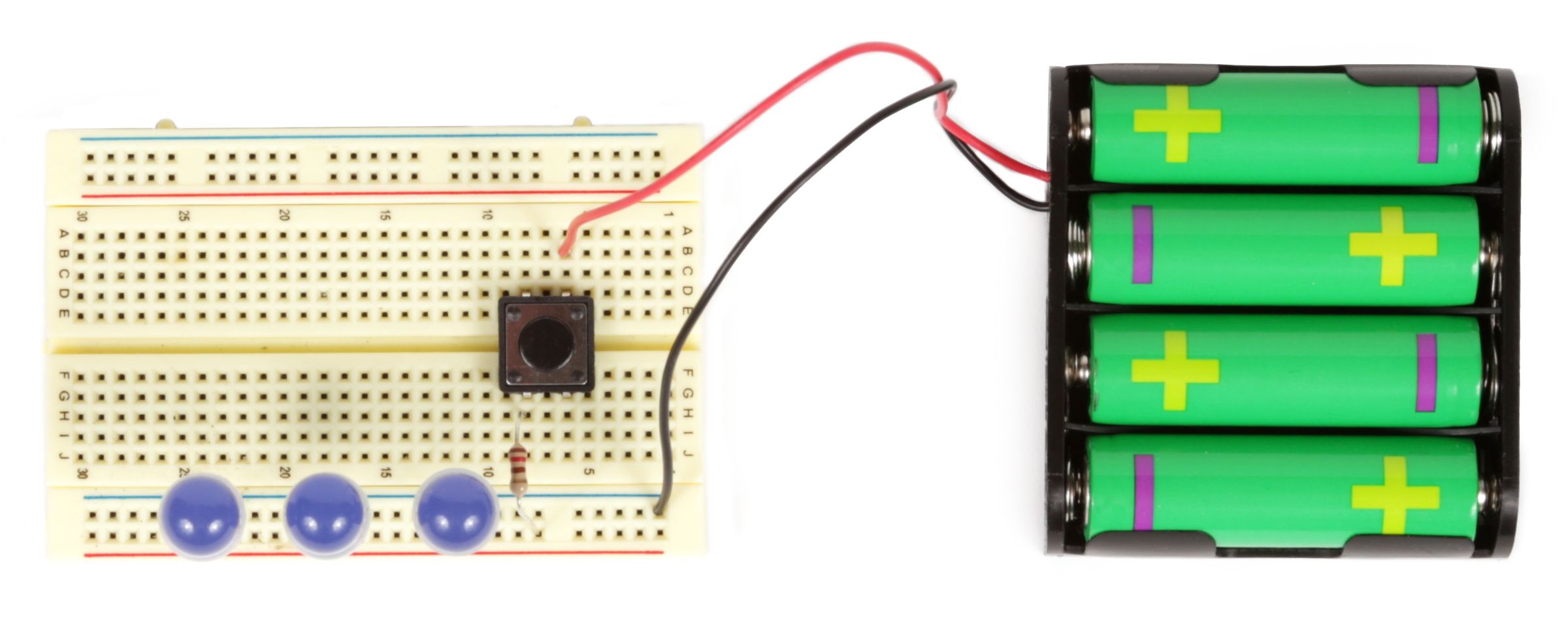

Well then, you may be wondering how you can power anything if batteries are only 1.5V? The answer is rather simple. We connect them in series.What this means is that we connect them front-to back in a row. So the positive (plus) end of one battery gets connected to the ground (minus) end of the next battery, and so on, and so forth. We can then calculate the new voltage simply by adding 1.5V for each battery in the series. So, if you have three 1.5V batteries in series you could multiply 1.5V times three to get a total of 4.5V.
The easiest way to connect batteries in series is to use a battery holder. To calculate the voltage that a battery holder provides, you simply need to count the number of batteries it holds and multiply it by 1.5V, just as you would with any other set of batteries connected in series. So, a 4-cell battery holder would produce 6V of power (1.5V x 4 = 6V).
To access the power provided, simply connect the red wire to the positive terminal on your project, and the black wire to ground. As a reminder from earlier, red wires always indicate a positive voltage, and black always indicate ground.

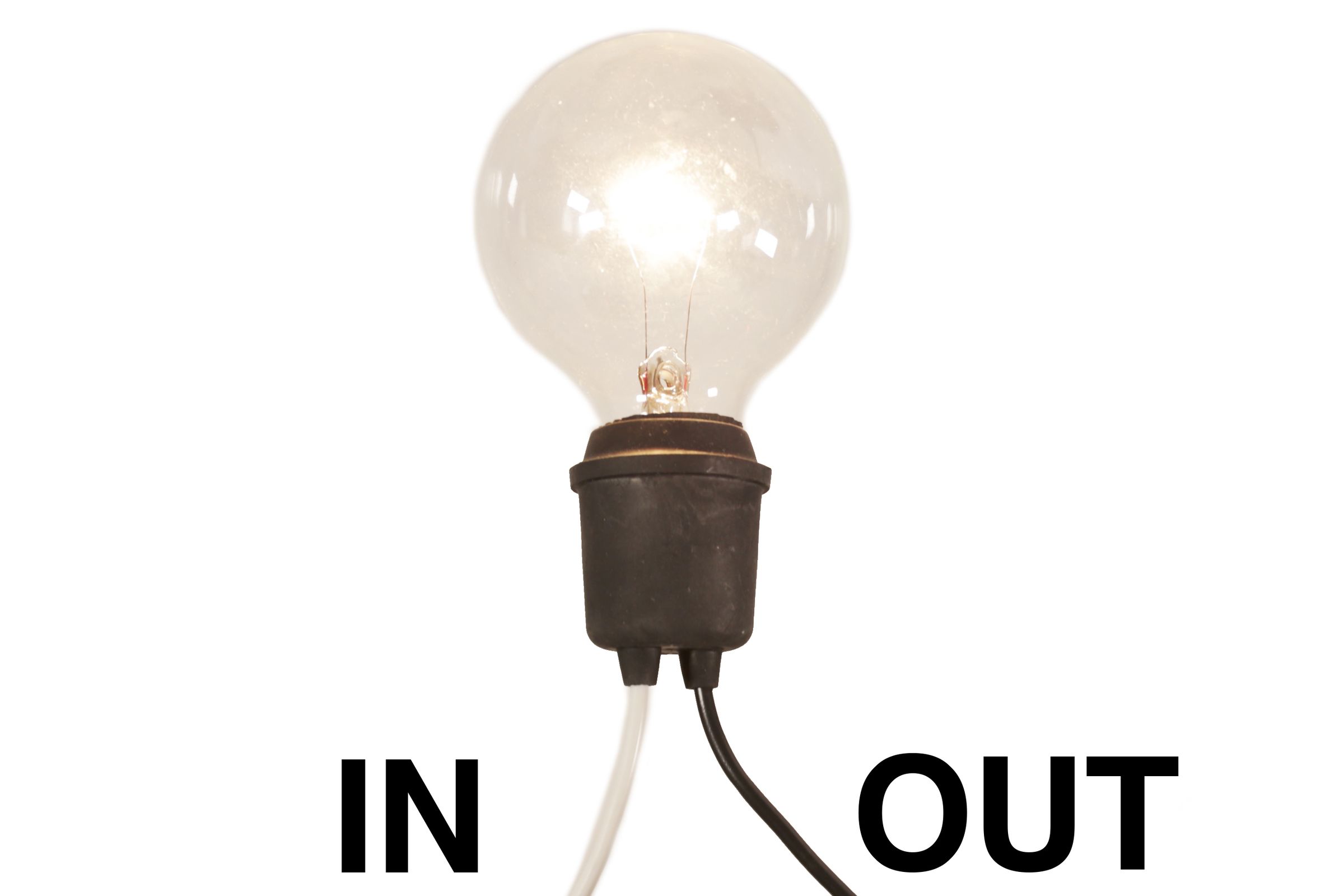

A circuit is a complete loop in which electricity can flow. An ideal circuit is any path in which electricity can flow from start to finish and pass through a Load, where the energy is put to use. This Load can be almost anything that uses the power, such as a light bulb, LED, or EL wire.
Circuits for lights are usually fairly simple. A power supply is connected to both terminals on a light source, and then electricity is allowed to flow through it, which completes the circuit and turns the light on.
That is the most fundamental circuit that can be made.
Of course more complex circuits can be made. Multiple lights can be wired together in series and/or parallel, or a switch can be placed in series to turn lights on and off. Additional components can also be added. For instance, when dealing with LEDs, we will also include a component called a resistor in series with the LED. However, more on that in a bit.
