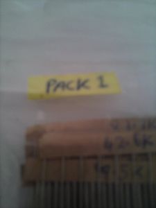

Well its time to put everything in order and catalogue all the electronic components that you have at your disposal for easier reference and rapid prototype. When I have purchased resistor packs, they have always come in un-labeled packs . In the picture, you will see a number of resistor bags, holding resistors of different values to each other . To start with, before even opening the bags, I have labeled them : packet 1, packet 2, packet 3 etc ........................ .

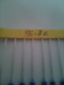

To make this filing project easier to understand, I will call resistors taped together in a Row, Files . First pick up the packet labeled 1 and remove a file of resistors . Get a pen and mark on the File the number 1 .
Step 1: Label Pack 1 to 12 Etc
Next pick up another File of resistors and mark this number 2 , keep repeating this going in sequence 3,4,5,6 until all the resistor Files have their own identification number .
Repeat this procedure for Packet 2 , Packet 3, Packet 4 etc .

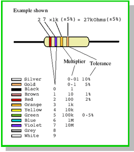

Once all the resistor Packs and Files have been labeled with their own numbers, its time to identify each resistor by its resistive value . The traditional way is to look at the colour banding of the resistor and match it up with charts, ( if they are available ) .
But this is tedious and unreliable .
A faster way is to test each resistor's value with a Tester meter, and mark the results down on a reference chart (which will form a part of using the resistors for circuits) and should be kept with the Labeled resistors .Also put the resistance value on the resistor file .
This is the chart I obtained from testing each resistor in each pack . The result is the average value for each File of resistors . k represents thousand . The number in brackets is the File number . The number next to it is the resistive value obtained .

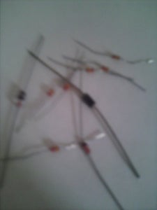

For diodes, you can catalogue them the same way you have been doing for capacitors and transistors . You can even put down which type of diode they are .
List of diode types to be isolated to their own group are :
Diode Switching
Diode Rectifier
Diode Zener
Diode Germanium

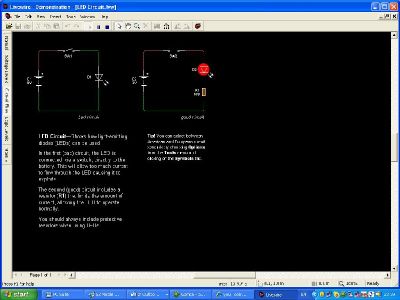

Step 7: CIRCUIT SIMULATION

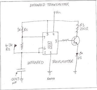

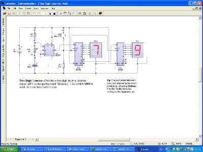

When you download circuit schematics off the internet or copy from books or even experiment with your own designs , its best to try and simulate the circuit first to see if it works before building the project for real . There are a number of circuit simulators out there, with their own library of virtual components to test before purchasing the actual components .
You can build your project in a virtual world at no cost and save it to disk for completion later . You can even join a project from another design to a project to a different design to work together as one project, and simulate it to see if it works .
You can download a free working demo of a circuit simulator from :
http://www.new-wave-concepts.com/lw_dl_ed.html
or one that works strait off the table:
http://www.yenka.com/
The Demo is good enough to do your own designs for free without having to purchase it and it already has a library of working examples of schematics .
If you decide to purchase the software after using the demo, the serial number they give you, is only good, so long as you don't wipe your hard drive clean . Because the serial number will not recognize your computer after re-installing your operating system .You will have to order another serial number ( for free ) from the vender .
After download, open the program and go to ' File ' , ' Open ' . Choose Electricity file . Open ' Livewire Demonstration - [LED CIRCUIT]
Try the demo out . Then copy the circuit first on paper, and try to design a way you could implement another switch and LED Light into the circuit and then run the circuit to see if it works .

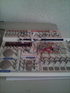

You can also either buy your own electronic lab like in the picture, or just an ordinary small plastic bread board with numbered holes to create your projects on .Will still give you a good start with electronic projects .
