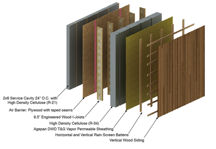

Typhoon Resilient and Sustainable Designs:
During typhoons and floods, it is essential to make sure that vital house systems are raised above the water level. For this reason, the boilers are situated on this floor instead of the ground floor so that they can continue to provide hot water and heat during harsh conditions, ensuring the well-being of the inhabitants. The boiler is located in the stone structure of the house where pipes connect it directly to the exhaust and ventilation vents above.
To make the home resilient to strong winds and moisture during typhoons, the edges of the house are mostly rounded but still include some sharp edges to add a modern touch. This is a key element in typhoon-proof homes because rounder designs allow better distribution of pressure from high winds. Compared to large flat walls, rounder walls prevent pressure build-up from typhoons to cause structural damages.
The materials for the walls themselves are also fit for strong winds and moisture. Some of these include stone and the walls themselves consist of different layers for structural integrity and reducing heat loss. The windows also need to be impact-resistant in case of flying debris. Because of their large size, they have large frames as well to secure them to the walls.
