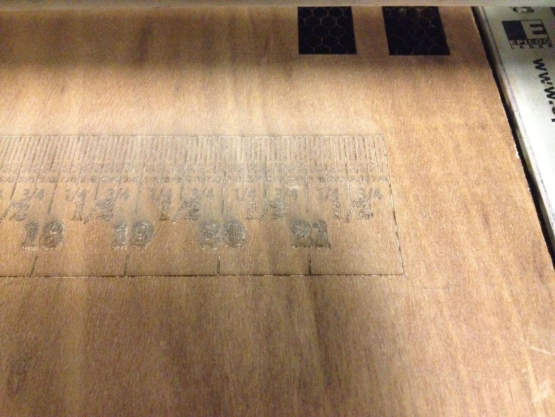

Step 3: Laze!
Pew pew pew!
That is to say, safely and responsibly cut your approved materials on the laser-cutter. Clean up your stuff when you're done.
Step 4: Photograph!
(Seriously, you'll be happier if you document your projects.)
Clockwise from the top, I have (1) the front-piece, with both cutting and etching, (2) the bottom-piece, with just cuts, and then (3) the center-piece.
I originally meant to etch the numbers on the center-piece. But I forgot to switch the settings!
And it actually worked out for the better! It took less time than etching, it looks cool, plus the punches are already somewhat started, since the numbers are cut clean-though.
Serendipity!
