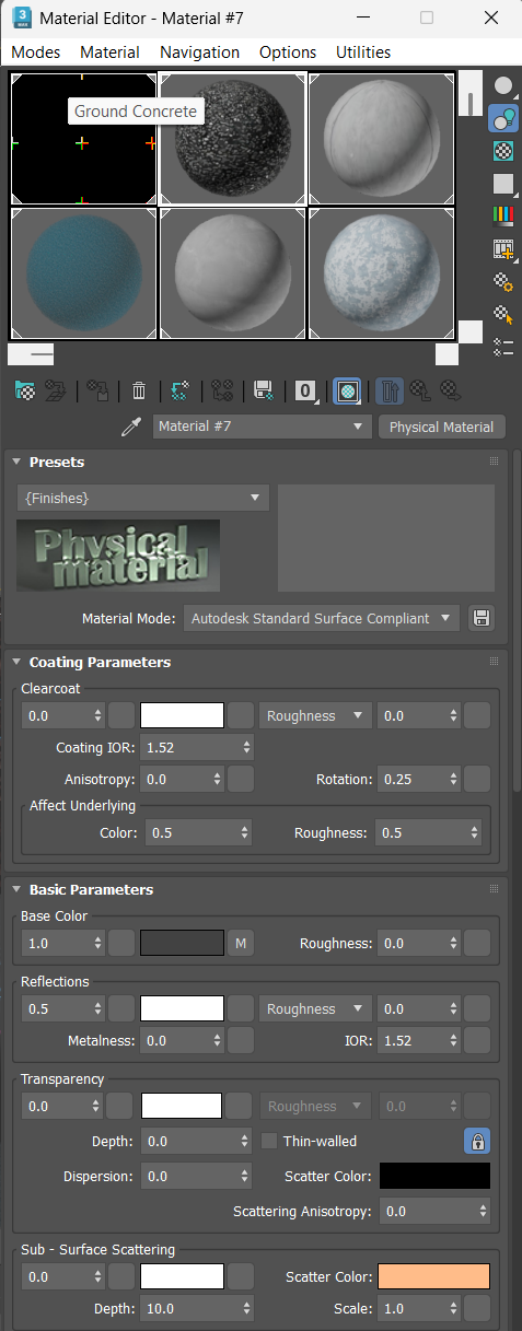

After I had finished putting all the objects and details into the scene, it was now time to detail the details. I applied materials to all of the objects in regards to what they were. Then, on those materials, I applied an extremely high bump map to make the materials appear more realistic and less flat when rendered. I also applied a high reflection on the materials to give the appearance of them being wet from the rain.

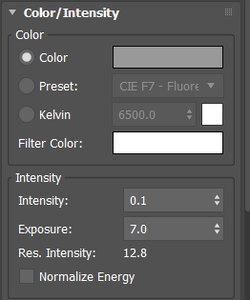

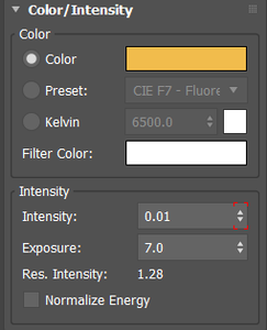

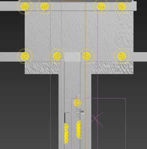

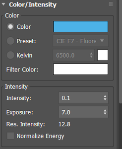

Well, the name of this competition is "Make It Glow," so now is finally the time to get into the lighting. To start, I added an overhead light that just serves to slightly illuminate the scene and create the effect of a dim moonlight. I then added lights that would make sense in the context of the world, for example, like the light in the doorway and the street lamps just around the corner of the outside of the alley. Then, I added the "main event" lights, the neon lights that glow at vibrant colors. I don't really remember why, but I decided that I wanted to create a cyberpunk-like scheme, so I chose a bright blue and purple for these lights. Again, they need to make sense in the context of the world, so I created two signs from which the light would come from. I adjusted the brightness of these lights to fit the general mood of the scene (I spent a bit too much time trying to find the perfect lighting).

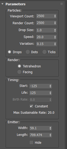

This was the most difficult part of the process of this project as I had never really created rain, so I had no clue where to start. However, then I remembered learning how to use the spray particle system. So, I just blanketed the scene in a spray particle system and created a gravity force and deflector, linking them both to the spray. I adjusted the bounce height and parameters of the deflector until I was satisfied with the result and set the spray to render tetrahedrons. To make them look good while rendering, I turned on motion blur for the camera and also applied a translucent material with a little bit of emission that would make the rain slightly brighter and more visible to the camera.
