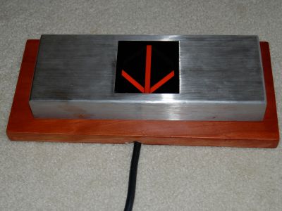

A few years ago all of the elevators in a local building were redone. A friend of mine saw all of the parts that were being thrown out and got permission to scrounge. We searched and found several items of interest. The best part that I took was the up/down arrows used outside the elevator on each floor.
I decided I should definitely make use of these arrows in some way. I decided to keep it simple and just wire the lights for control on a manual switch. I did just that about a year ago but encountered a few problems with my original design. I have therefore have redone it and am presenting the improved version here because I now know how it should be done.
Goals
My goals for the project were:
- to have the lights easily relocatable,
- to have a switch to control on/off as well as the direction of the arrow,
- and for the lights to be safe and reliable.
This project has saved from a landfill what is now a unique and simple bit of functional decoration. I used a piece of wood too small for most applications. Also, I used an old computer power cable and many parts on hand.

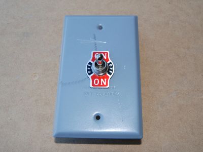

Cut a Hole in the Cover Plate
First you should cut a hole in the cover just large enough for the switch to fit through. The most effective tool for me was a high powered drill since I used a metal plate. Plastic plates should be easier and can even be cut using a knife.
Attach the Switch
Next you will want to attach the switch to the faceplate. To do this remove any nuts from the threads around the switch, pass the switch through the plate and replace the nuts on the other side. Use pliers to tighten the nuts.

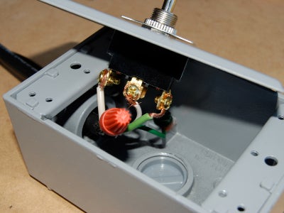

Wire the Switch
Wire the switch properly. Boxes made for house wiring will have holes already for passing wires in and out of the box. You will need one end of the 3 wire cable and one end of the 3 wire computer power cable to go into the box. The actual wiring of the switch is discussed in detail in the next step.
Attach the faceplate
After the switch is wired attach the faceplate to the box using the screws that came with it.

I used a computer cable to run from the wall to the switch box. I simply cut of the female end and attached it to the switch. I used some standard 16 gauge house wiring to go from the switch to the light. A fourth wire going from the switch box to the light would have been useful for a ground. The DPDT switch came from Home Depot. (This is important because most DPDT switches are not rated high enough to use for this. Make sure that the rating is for at least 15 Amps and at least 120 Volts.)
Wiring tips
Here are some tips for those unfamiliar to the world of electrical wiring.
The first part to wire is the switch box. Wire the black two wires together using a twist connector. Attach the white cord from the wall to a center of the DPDT switch. Wire the white to the lights to one side of the switch and the green to the other side. Wire the green from the wall to the green screw in the box. Note that it is very important that you make sure to wire the green from the wall to the box and the green from the switch to the light. Green is usually used for ground and thus the green wire from the switch to the light should be marked another color if possible.

Take the loose 3 wire cord end and put it through the hole in the back of the wood and then attach the wires (using the twist connectors) as follows:
Place the metal light housing on the wooden back and close the switch box. Before you tighten the bolts and screws plug it in and make sure that up is up and down is down and that everything works without problem. If all is well then unplug, tighten the nuts and screws and test again.
Wiring the Lights
- Green to red
- White to brown
- Black to black

That should do it. You can now enjoy a reused, simple up/down arrow. Use it to indicate your mood, or whether or not you are accepting visitors, or for anything else or nothing at all. I hope you enjoy this and if you have any feedback please feel free to drop a comment or personal message.
