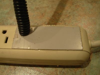

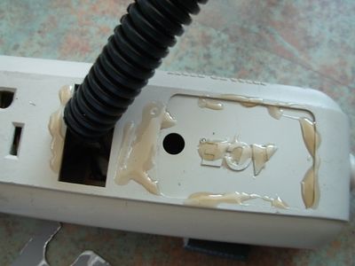

Step 6: The Little Metal Thing That I Can't Come Up With a Name For
To keep the cable wrap in place, and keep everyone else away from massive amounts of current, I figured I'd add a little metal piece to go over the open holes. You can use, metal, plastic, or maybe wood (but wood catches on fire). Cut your material to fit over any open holes. I made mine extend to the end of the power strip so it looks a little cleaner. Then cut a notch with a Dremel that the cable wrap will rest in. If you make the notch just right, it will sit in between corrugations in the wrap, locking it in place. Verify the proper fit, then apply small amounts of Gorilla Glue to the power strip where it will go.
Clamp the piece down evenly and let it sit for a few hours to dry thoroughly. Once it's dry, set up your new, improved anti-standby power strip!
