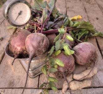

  1. Stainless steel saucepan and steamer
  2. Juicing machine (The Sage Nutri Juicer™ is recommended)
  3. Water distiller (Smart Still)
  4. Alcoholometer
  5. Hydrometer
  6. 15mm copper pipe x 200mm long
  7. 4.5 litre demi-john
  8. Airlock and cork
  9. 10 kg fresh beetroot
  10. 5g beer yeast
NB. 1 kg beetroot gives 400ml juice with my juicer.
